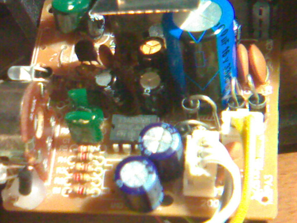

I have a cheap 2.1 sound system which has a small problem and i wanted to repair it just for educations reasons :p the problem is that i can hear a steady noise comming from the sub-woofer no matter how high or low i have the volume.
The noise is like if no smothing capacitor exists! i changed the smothing capacitor 2200uF/16 with a 3300uF/16 and nothing happend, i also changed all the other small decoupling 100uF/16 with new ones better quality and again nothing happend. Now i was thinking to change the 100uF/16 with bigger ones 220uF/16 believing that they don't have sufficient capacity to filter out the power line noise, but before i do that i wanted to hear some opinions of what might be the problem.

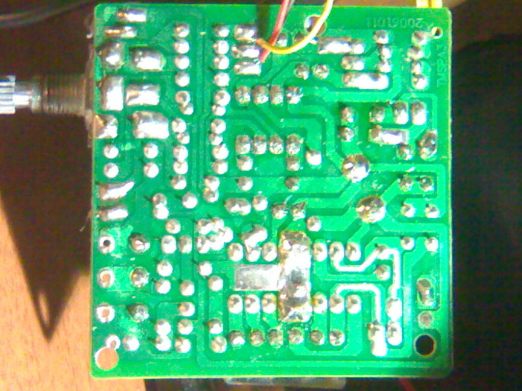

here's some photos, pointless maybe but anyway...
There is a connector with 2 thick wires and another connector with 3 thick wires. One connector has AC from the transformer and its wires must be kept away from the volume control.
The rectifier diodes might be radiating a buzz into the nearby opamp wiring.
