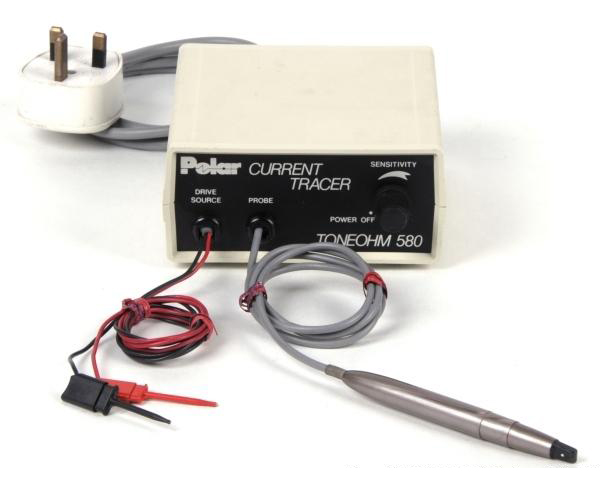

sounds like you want a toneohm, i have one here it dosnt work because its the older version and has the wrong probe, but if you want i will take the back off and take a pic of the insides, or google service manual for the tone ohm
Are you talking one of these?
yep i have the 550 but some numpty wired the 580 probe on so it dosnt work
yeah was like that when i got it in an auction but i dont know how to put it right, it shouldnt have the probe i think it has two normal ones into the one plug
oh a numpty is like a idiot only a bit more stupid
