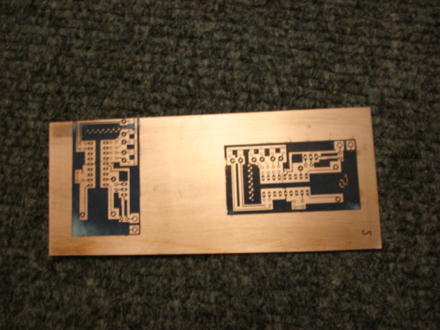

It did just what I thought.. JAMMED.. I had to pry it out after removing the toner and the fuser from the printer. It is to thin.
Now I must be fair, it was my wifes Christian magazine not an old EDN.. I could not find any of mine to cut up (funny how that works, but my wife was cool about it).
So far as the rag paper you need to use thick paper.
Anyway, the other day I was in Circuit City for a part and I saw "Kodak picture paper" on clearance. I thought "picture paper" I use it to make circuit boards maybe I should try theirs at 1/2 the price on clearance. Worst case print pictures on it.
Now this is in the States, clearance $4 for 25 sheets and $8 for 75.. I bought a pack of 25 to test with when I had some spare time. Funny we have no spare time, but we all meet up here.. :D
So after the magazine paper jammed I stuck a sheet of the Kodak paper in.
Guess what!? I am going to Circuit City in the morning to buy a couple 75 packs. It killed Staples picture paper.
To add to the magic of picture paper over press-and-peel (price wise) I put the sheet in upside down and printed on the wrong side (by mistake), then did it on the right side.
For fun I cut them both out and ironed them.. Did the 5 minutes in a warm bath. Both came out great and no toothbrush or exacto required. A lot less work than Staples picture paper.
See the picture, sorry for the blur, but this took 15+ minutes less to get ready for the etchant. The right side is the photo side of the paper (S in lower corner). And the (S side, the correct side) was less work that the wrong side but both were less work than the Staples paper..

Edit: Wow mramos, those turned out great. Better than mine for sure. I always get impatient with the iron and/or do not have enough space on the board to get the edges to stick well.
Are those just example? Or are you going to actually use them? You know, you coukd put them side by side to save your self some PCB material.

Old circuits and I just ironed them on to see how hard it was to get the film off the copper.. I will acetone them in the AM.. If you note, the vertical one (left) is not even 100% on the copper.
It was a test and I am really happy with the results. I will never use Staples picture paper again after this..
