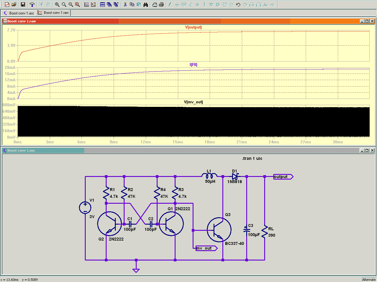

Why not indeed? So that's exactly what I did. Here it is (the LTspice file is attached below):
It not only works in LTspice simulation, but also in real life. (Slightly different results, but never mind.) Of course, it comes nowhere near the Minty Boost, which can deliver a hefty 500mA at 5 volts; the best result I was able to get was 6.5 volts at 18mA (with a 390Ω load resistor). The best I could get from the LTspice simulation was 7.7V @ 19.6mA.
I think this idea has promise. Of course, this is just a starting point, if indeed there is some better ending point out there. After all, it is totally unregulated in its current form. Just raw output. (That may be sufficient for some applications that don't require good voltage regulation.) That's one of the issues I ask about below.
So comparing this to the Minty Boost, I wonder exactly why this is so much more wimpy. After all, if you strip down the Minty Boost to its essentials, you get this:
Looks familiar, no? The only difference is that the main works (oscillator and switch) are inside that little chip.
So why can't I achieve at least close to its performance with a more humble circuit?

Having no way to measure frequency here, I have to rely on the simulation as my guide. LTspice tells me that the switch is being driven at about 300kHz, a respectably-high frequency. But of course, one question is whether the on-time parameter is really what it should be. Especially since the multivibrator waveform (again, the simulated waveform) looks like this:
Not very symmetrical. Now, it would be interesting to learn what effect making the multivibrator "lope" would have on the converter performance--that is, making the two times unequal (different R or C sizes). Any thoughts on this?
The inductor value also has me mystified. According to my book on power supplies, the formula for the inductor value is
L = Vin * Ton / Ipk
which gives me a value somewhere in the millihenry range, not microhenries. (Using Ton ~= 2.3µS.) (Here, we're supposed to size the inductor based on the minimum current, which makes it larger.)
So which way should I go here: where should I be frequency-wise? What's the best way to match the inductor to the switching frequency? How about using something beside a BJT for the switch: MOSFET? something else?
Thinking ahead, it occurs to me that instead of just sticking a 7805 in there to waste some electrons and give me 5 volts, maybe I could come up with a quick-and-dirty regulation scheme, like frequency-modulating the multivibrator (basically implementing some kind of VCO). Possible?
The fact that this works as well as it does is intriguing to me, and leads me to belive that there's much more potential here. Now imagine that this could be cranked up to deliver 9 volts: that would be a really nice way of eliminating 9-volt batteries in small electronic devices.

The switch transistor is not being driven hard enough to get a decent output.
The RHS of the multivibrator is only being allowed to reach 0.6V, therefore the uneven duty cycle.
Add a buffer to the multivibrator output and you'll see an improvement - even just decreasing R3 and inserting a base resistor onto Q3 (as per attachment) will give an improvement over your reported results (better than 9V out, but I didn't bother waiting for it to stabilise).

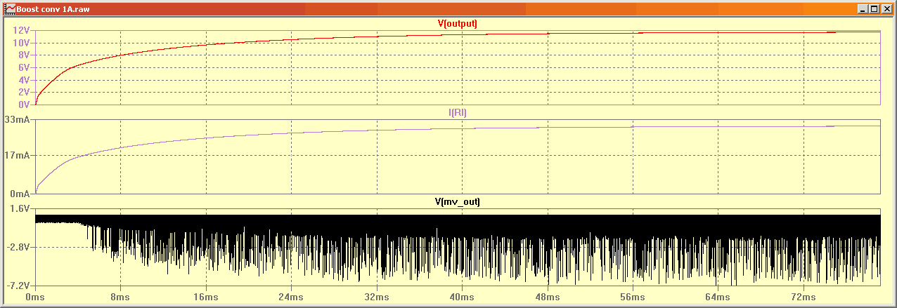

So I implemented your suggestions (see new attached .asc file), and was pleasantly surprised at the improvement. Not an order of magnitude, but very noticeable.
I changed the MV collector resistor to 470 as well as the drive base resistor. I also changed the MV caps to 220 pF, bringing the MV frequency to 75 kHz. In the simulation, I get 11.7 volts at almost 30 mA. (My breadboarded circuit isn't quite so good, since I only have a 100uH choke instead of a 50, but it's definitely better than before too.) So I still think there's more power to be coaxed out of this little device.
But it's getting too late now, so I'll have to pick this up later ...

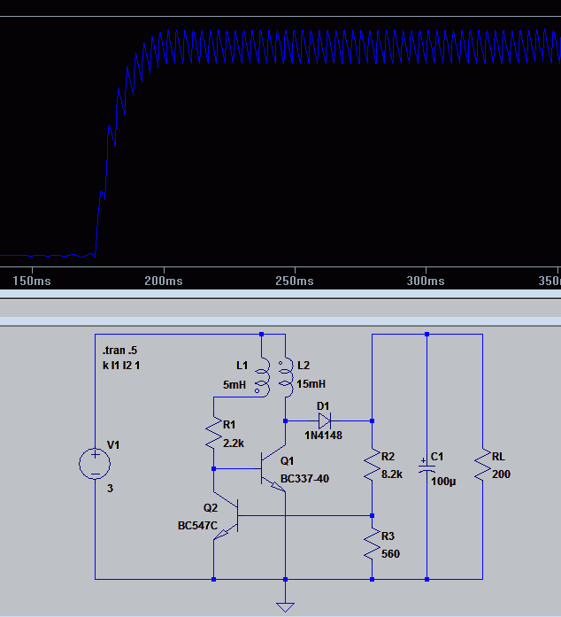

One problem with your oscillator is that good power transfer requires the right duty cycle to suit Vin and Vout. You have a fixed duty oscillator and no feedback.
The best bet with a simple design is to run the oscillator duty set for high power transfer, then regulate it by reducing duty when the output voltage is reached (which is pretty much what Dougy83 said).
Or an even simpler system regulate at a fixed inductor current like this 2-transistor boost converter;
https://www.romanblack.com/smps/conv.htm
which gives good power transfer as inductor current is well controlled, but runs at a fixed input power so it's not ideal for battery use.
Another little factor is the ability of the transistor to remain in saturation for the entire duration of the 'on' pulse. If it starts to pull out of sat a simple fix might be to increase the inductor value to 200uH. That lowers the peak current and the transistor may then make it just the way it is driven now.
Another factor is the inductor series resistance. 2 ohms is very high for these kinds of circuits unless you have a low output current. Try 0.1 ohms instead, but make sure the transistor stays in sat for the full 'on' time duration.
.....Different: You can use the joule-thief type blocking oscillator you've already been playing with. It has the advantage that it sets its own frequency based on the saturation limit of the coil or transistor. Just add a means of regulation and you're done.
Aye, there's the rub. There's no easy way to regulate the output voltage of a joule-thief other than using a lossy linear regulator.

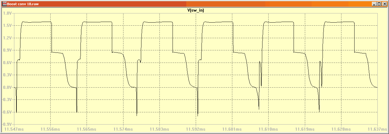

I added a buffer/amplifier stage before the switch, as suggested by Dougy (.asc file attached) and saw another fairly big jump in performance. Maximum output was now 12.6V @ 32mA. Not bad; now we're talking some real usable power here. (In simulation, of course.)
The buffer changes the shape of the driving pulses (pic attached), which is now both better and more problematic. Better because I now see something approaching a clean 50% duty-cycle square wave on the tops of the signal, but the bottoms are still spiky and ringy. So as Dougy suggested, there is the solution of simply clamping away these faults, but that seems like a brute-force method. Is there anything else I can do to my setup to minimize this stuff? But more importantly, should I really be concerned about the "ugly" look of this waveform? does it really matter to the operation of the switch? or is it good enough? (And then there's still the unresolved question of duty cycle. Yes, I know, this is going to take more research on my part. But hey, if you have any suggestions ...)
The base of the switch is now being driven pretty hard (~1.5V). Is this hard enough?
Also, I had a hell of a time setting up the buffer. The only configuration I could get to work was this emitter follower. Anyone care to give me a just-above-noob-level critique on this? is there a better configuration? different resistor values?
Ideally I'd be able to drive the switch directly from the output of the MV. Is there any way to do this by rejiggering things here, without adding another transistor? (I get the sinking feeling that every transistor I add is just drawing more precious current from my battery source!)

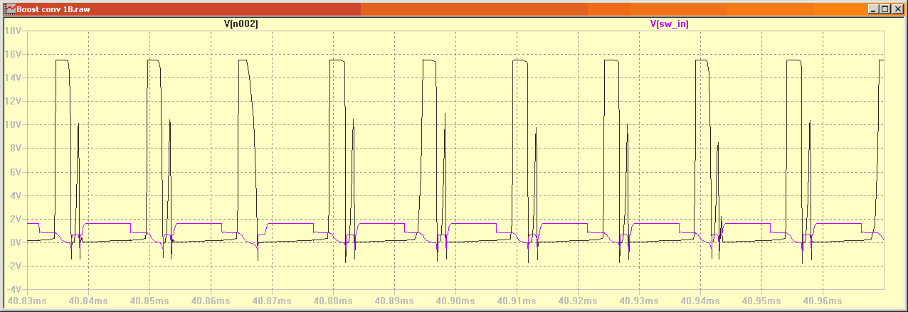

What does your collector voltage waveform look like? Lets see if it stays in sat or inductor runs out of juice :)
See attached pic of collector voltage. As you can see, it's fairly narrow pulses. I don't know how to interpret this: is this good or bad? how can you tell if the transistor is in our out of saturation here? (The small purple waveform at the bottom is the switch base drive.)

Your inductor is running out of steam. That's why the pulse looks so narrow. If it runs out of energy it cant produce current anymore.
You can use the multivib to drive the transistor as you did, but you can only expect so much out of that unless you lower impedances or use another drive transistor.
The main idea is to make sure the inductor gets the full battery voltage for the required time that the transistor is on, and that the transistor stays on for the whole time and does not pull itself out of saturation because of high collector current vs base drive, and also to make sure the inductor has enough energy to produce the required output voltage. There are some formulas if you are interested. With 39 ohm load you can get 150ma, but im not sure what output you want to get there.
To get more current you need to reduce your load. Try 39 ohms. If you still have a problem, i'll post the whole circuit with only the change of 270 ohms, 200uH, and 39 ohms and a little series resistance for the real world battery simulation.

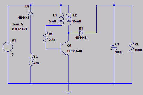

I'm not sure that's true.

Regarding Regulation
It seems to be coming to that part of the project where I should start to think seriously about regulation.
Since the converter is supposed to be as simple (some might say primitive!) as possible, the following scheme occurs to me:
Should the output voltage rise over the setpoint, the zener conducts, turning on the transistor, which then ... [does something, not sure what] to slow/stop/delay the multivibrator.
Precision regulation is not even a design goal here. Close enough is good enough.
There's a bunch of ways to regulate a joule-thief type converter. A couple might be:
1) Colin has posted one sometime back that shunts the oscillator transistor's base current as a means of regulation, something along the lines of this:
It's not the exact the circuit I was thinking of). It's not my favourite method, due to the fact that the shunting wastes energy. By inverting the logic to control the sourcing of the base current to the oscillator rather than diverting it that problem is removed.
EDIT: actually, the attachment is the one I was thinking of (is this circuit in carbonzit's posting anyway?)
2) adding an extra winding and rectifier which connects from GND to VIN, which will regulate the output based on the input voltage. The inductor energy during regulation is returned to the input capacitor so it's not completely wasted.
EDIT: 2nd attachment shows this basic concept

Already done that. Here are the results:
Rl-------V------I
40Ω----7.7----194
50Ω----8.1----163
75Ω----8.7----116
100Ω---9.2-----92
So we're starting to see this thing's V-I profile.
Looks like a pretty respectable 9-volt converter with a 100Ω load ...
Hmm, with your 200µH, I get 9.7V @ 97mA. That's nearly 1 watt.
