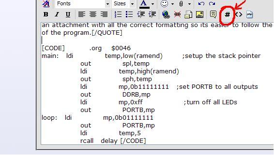

Salgat said:
Reading that code is extremely hard on the eyes. Upload it as an attachment with all the correct formatting so its easier to follow the flow of the program.
Or use the code tags to maintain formatting, like this:
Either click on the # in the menu just before pasting your code, or type the tags in yourself manually.
Then your posted code will look like this:
	.org	$0046
main:	ldi	temp,low(ramend) 	;setup the stack pointer
	out	spl,temp
	ldi	temp,high(ramend)
	out	sph,temp
	ldi	mp,0b11111111		;set PORTB to all outputs
	out	DDRB,mp
	ldi	mp,0xff			;turn off all LEDs
	out	PORTB,mp
loop:	ldi	mp,0b01111111
	out	PORTB,mp
	ldi	temp,5
	rcall	delay
Instead of like this:
.org $0046
out spl,temp
out sph,temp
out DDRB,mp
out PORTB,mp
out PORTB,mp
ldi temp,5
rcall delay
