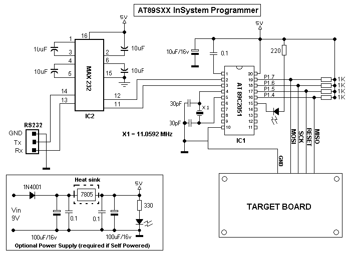

recently i've hard that atmel has stopped making AT89c51/52 and is replaced by AT89s51/52..
is that true...
and if yes then... is that also true that AT89s series can be programmed serially...
if yes then can someone give hint where can i get the schematic and software for programming this microcontroller...:)
Try this
Firmware for AT89C2051 & Flash Programmer Software in the attachments.
  • Firmware v1.2.zip
  • ISP_PROG v1.2.zip
Target board
That’s the board with socket that you place your chip (the empty chip which you are going to program)
It consists of 5 lines with ground. The programming pins in the ATMEL chip (the pins that help to program) must connect to this five lines coming to the target board.
If you need the VDD line as well you can bring that line too.
The chip already there in the circuit is used to program other ATMEL chips. It must load the FIRMWARE first but it must program from another programmer.
After you program the main chip (89C2051) it must there permanently. After all these done you are ready to program other ATMEL chips.

hey guys... i have some questions here...
1) As mentioned, the AT89C51 must be load with the firmware first.. but Im not sure how to do that.. isn't just construct the circuit, then placed the AT89c51 permanently in the circuit and load the firmware from the Laptop COM port to the entire circuit?
2) Can I use AT89c52 instead of AT89c51??
3) From the target board, where should I connect the 5 lines to my AT89S51 which have 40pins?
hope u guys can help me asap... really urgent... many thanks!!!!
This is the worst part, you have to program the AT89C51 from a different programmer from your friends’ ones etc…..
The firmware is written to AT89C2051 you have to use the same.
See the data sheet it contains the programming pins which used when programming.
