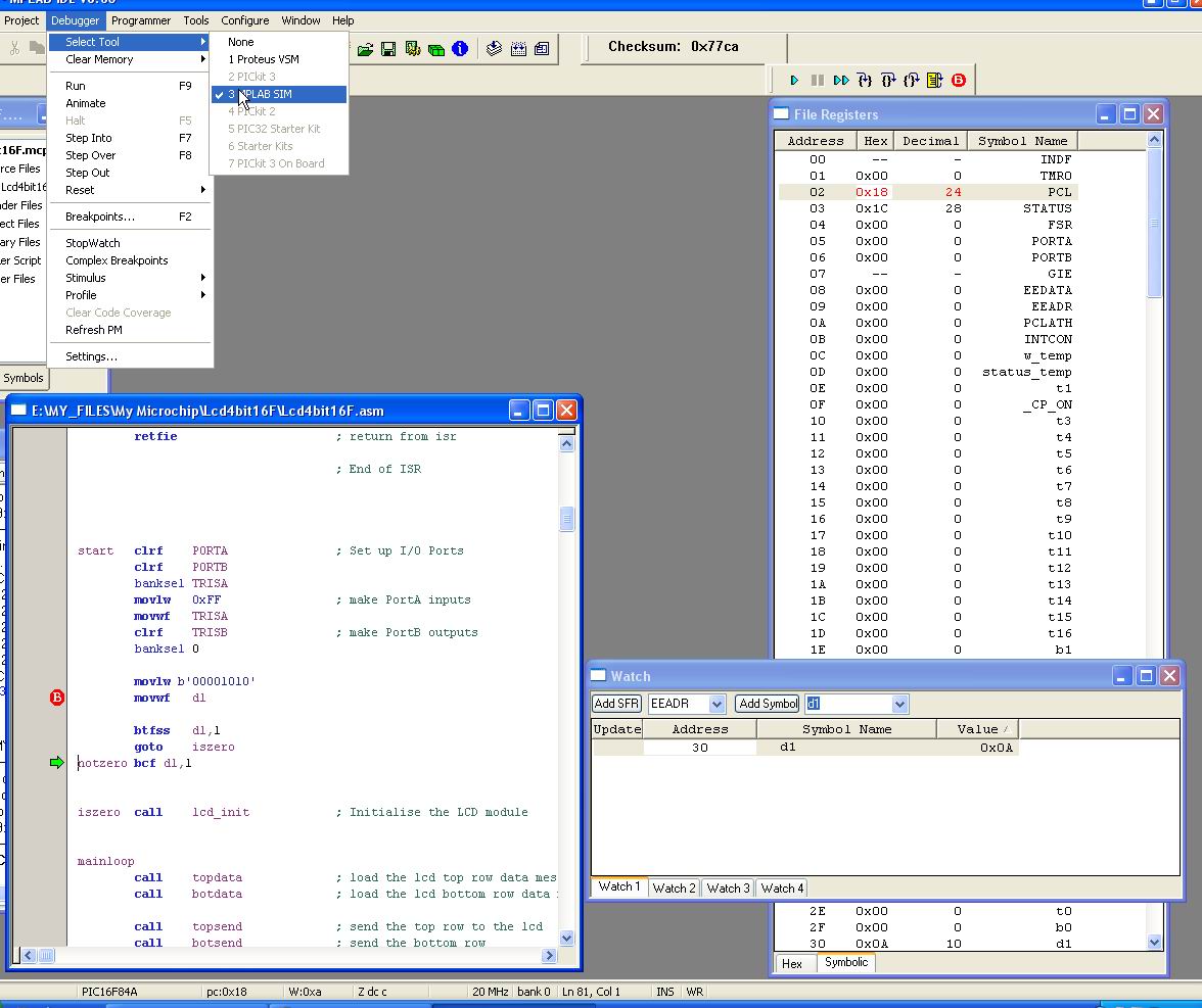

Do you use Mplabs Sim ? - its very helpful for single stepping through your code one instruction at a time and viewing W and the registers values changing in the Watch windows
