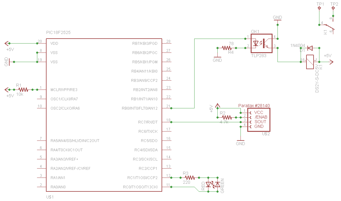

cool thanks. I added a relay circuit and now can control a nice high voltage. using a Optocoupler instead of transistor and a nice relay:
2A @ 30VDC
1A @ 125vAC
