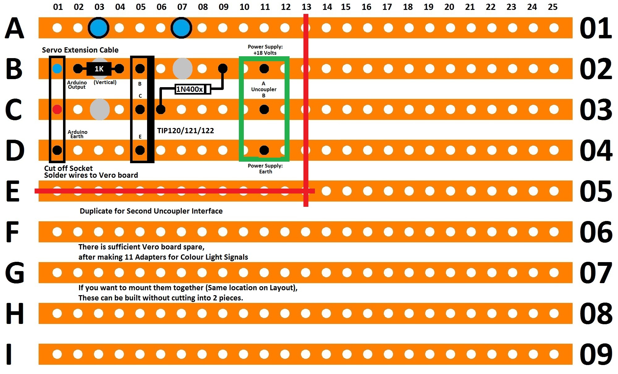

Hi , I have 3 Arduino Nanos mounted on prototyping shields and was being guided on a model railway DCC computer controlled project to use them for controlling Eleven 2 aspect colour light signals ( 12 V led's) plus 5 RC servo operated Semaphore arm type signals and 2 Electromagnetic uncouplers ( 18V DC ), unfortunately the guy who was guiding me and sending me drawings and advice has disappeared of the net ( 2 months) when I had been receiving emails virtually every day , he sent me a list of all i'd need and I purchased everything he listed and he also sent me 2 of the 3 diagrams I would need to constuct 3 types of circuit on veroboard , the first circuit for a voltage and brightness adaptor was extremely simple and I have constructed eleven of those so i'm now turning my attention to the second circuit which is for the uncouplers , I have attached the drawing he sent me and have a question about it , Was it his intention that the Green 3 way screw terminal at the right hand end be connected to the uncoupler Red /Black leads and the 18 V DC supply , the Blue dots btw represent suggested mounting holes and the Grey dots are cuts to the tracks , if I can get these made I can then move on to the last circuit which I have no vero diagram for but I do have a Schematic i'll need help with .

hi gary,
I would say it is as this modified diagram.
E

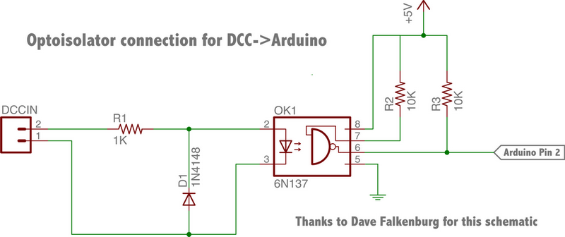

Thank you Eric , it is as I thought then , I did'nt want to go ahead and get it wrong and maybe lose some components if they'd been misplaced , you may be able to help with the last of the 3 project boards for which I only have a Schematic so i'll attach it here just in case you can , I think I can decipher the schematic ( electrical knowledge is only a little more than basic ) but can you tell me if I need to make cuts to the veroboard to make this please ?.And also during our email conversations the guy asked if I had any 36 volt Capacitors but did'nt mention why .

hi gary,
As I am not a model railway builder, I need to ask a couple of questions.
What is DCCIN, ie: voltage level.?
Any idea why your previous helper decided to use an opto-coupler isolator.?
Usually opt-isolators are used when it important to have electrical isolation between two parts of a circuit.
The 6N137 is a 8 pin DIL, this means two rows of 4 pins, the left side 4 pins are the Input and the right side 4 pins are the Output.
For isolation the copper track between the 4 left pins and 4 right pins needs to be cut.
A image clip showing more or all of the circuit would be helpful.
A 36V Cap is usually specified when the applied voltage can be upto say 30V
E

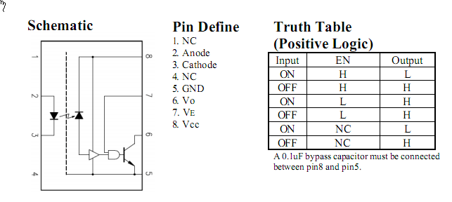

Hi Eric , DCC is a modified form of AC used on more advanced model railways, it carries both the power and the data needed by a model locomotives built in DCC Decoder my system has it set at 16 Volts by default but it can be adjusted between 12 and 20 volts depending on needs and model locomotive scale .I believe an optocoupler is used because DCC would destroy an Arduino and it seems to be common practice as far as I can surmise .Having looked at your attachment I notice it mentions a Capacitor so i'm wondering if the guy intended the 36 volt cap to be used with the optocoupler circuit in my attachment ? , I have found what may be a better diagram on the net and have attached it here .

hi gary,
That cap is only 270pF, its a electrical noise filter before the opto.
I would say a 36V wkg Cap would not be intended for that part of your circuit, the voltage is clamped by the opto emitter diode and the 1N4148 diode.
As the DCC has a voltage range of 12v thru 20v, the opto coupler is being used as a level shifter and/or an isolator.
Your previous helper seems to have experience on your type of project, so I would fit the 6N137.
Is the DCC voltage supply, 0v/Common/Gnd linked in anyway on your project to the Arduino 0v/Gnd.???

Hi , yes it seemed to be a good one when I purchased it after having done some research , i'm still unclear about the Capacitor and whether the guy intended it to be used with the uncoupler circuit or the optocoupler circuit ? and whichever is the case whether a 50 V one would be ok ? , i'm quite happy about constructing the 2 uncoupler boards now excepting the question regarding to 50V cap .
50v will be fine, you can replace a cap in a circuit with one of a higher voltage rating no problem, if a circuit calls for 35v and you have a 50v no problem, up to an extent it will last longer.
The voltage rating of a cap is the most ot can withstand without failing, less that that is Ok.
If the optocoupler circuit was meant to have a cap like that it would make sense to be across pins 5 & 8 on the opto, pin 8 being +, but if your wires to the 'duino are not too long it probably wont need it, but wont do any harm.
