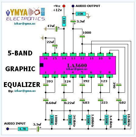

Im currently making an Arduino Synth keyboard for my microcontroller class. Im stuck on the equalizer part and effects. I dont want something very expensive so im trying to put the effects on my arduino mega. Still I have the pieces to do the equalizer in the output of the arduino doing the following chart:
Buttons (Keyboard) ----> Arduino Mega (Waveform Generator)--------> Preamp (Gain, Tube effect, Volume)----> Equalizer------> Amplified Speakers
I Wanted to make an passive EQ but failed in all my experiments so I was looking in the internet and found this active EQ diagram that is inexpensive and looks nice. So I bought the IC by Ebay. I Have diferents Caps and Resistors but not exactly the same as the diagram. How I can do a conversion there?

I Only have what I have I cant buy new caps and things because I have a limited budget. Still I can get that values or similar putting the caps in parallel- series and resistors? Still what stand for 393 124 392.. etc... in the diagram? that is uf? pf? mf?
BTW vvc will be 9V instead of 12V because all the other things uses 9V
I have to change the circuit sightly to meet what I have here. I want to now if it is possible modifing the wiring and circuit and using my parts (caps, resistors, etc...)

They are in pF, with the last digit the number of zeros - so 393 is 39,000pF (or 39nF, or 0.039uF).
You don't have a very good range of values, in fact only two - 0.047uF and 0.47uF - so there's really nothing you can so without buying some more.
I agree with Nige, the only thing I'd be looking at is designing round the 250k pots as yuo have a lot of them and they are expensive.
I can bypass a 250k pot with a resistor to get roughtly 100k I think.
thanks! ok this is the list:
393= 39nF or 0.039 uF
124= 120nF or 0.12 uF
392= 3.9nF or .0039 uF
123= 12nF or 0.012 uF
390= .39 nF
683= 68nF
223= 22nF
682= 6.8nF
but 1000 is ????
I Think that getting this kit and mixing with what I have I can do the job

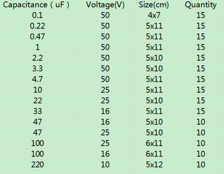

I tried to buy everyone individual with high quality and gets very expensive. I tried to get everyone individual and still gets expensive. I tried my best but the synth will cost me a lot buying all this things apart. BTW they are electrolytic caps.
None of the capacitors you asked about appear to be electrolytic, although as I said it uses non-standard (and confusing) symbols - but I presume that the electrolytic ones are marked with a plus (and the ones you asked about are too small to be electrolytic).
it comes in a package and sold as: 15 Value 200Pcs Electrolytic Capacitor Assortment Kit Arduino DIY Box 0.1-220uF
