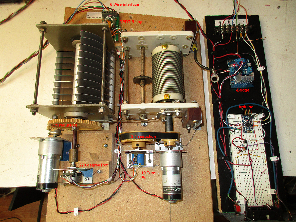

I put a 2:1 mechanical reduction between the roller-inductor shaft and the ten-turn pot shaft. The useful range of the roller inductor is about 17 turns, so this works fine. The ten bit Arduino AD provides more than enough resolution... I will post a picture...

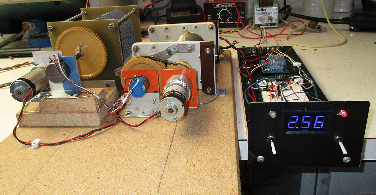

Here are two pictures of my breadboard (literally) as it exists so far:
So far, the control box just has two center-off switches (joysticks) for testing. The left one controls the capacitor; the right one controls the inductor; up to increase capacitance or inductance; down to decrease, respectively. Tapping the joystick makes one little step up or down. Holding the joystick for ten seconds steps once a second. Holding the joystick for more than ten seconds causes the gearmotor to slew at full speed.
The blue readout is just a voltmeter that shows the pot wiper voltage of whichever joystick was last pressed. The voltage is ratiometric to the Arduino's 5V supply, so is also read by the Arduino's AD converter and used to stop rotation of the respective shaft as the capacitor reaches min and max capacitance, and the inductor reaches the limit of its travel.
The two motors and the meter readout are multiplexed based on which joystick was last pressed. This makes possible the six wire interface.
So far, I have written Arduino code for positioning the capacitor and the inductor, checking the limits, slewing slow and fast, stopping at the limits, going to a specific position, etc. Now the real fun begins...
You did a splendid job on construction, really nice job :) What configuration are your tuning elements. If my memory serves me right, the one I worked on had series C (tunable), shunt L (multiple inductors switched in/out binary), and series C (tunable). It often took awhile to get a good tune ~ 30 sec, 10 MHz was always a trouble spot for some reason. I was a factory tech at the time so I never really knew how the code worked.
