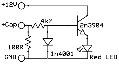

I am designing a circuit used for safe charging and discharging of a large capacitor (1F, 12V => automotive). An LED should indicate whether the cap is charged or discharged, i.e. I want it to stay on when the cap is being charged/discharged, and turn off once the cap is fully charged/discharged.
I've attached a basic idea, but I have no idea if it will work like that, this one is only for discharging. The idea is, when there is less than 0.7V applied to the +Cap terminal, the NPN should turn off, otherwise, allow current to flow through the LED (please excuse the missing pre-resistor :) ).
Please let me know your thoughts on this one.
Thanks!!
The circuit as drawn will not work.
You will need about 2.8 to 3 volts at the base of the transistor before it conducts, and when it does the transistoe and LED will be destroyed as there is no current limiting resistor.
The 1N4001 will clamp the base voltage at 0.6 - 0.7 volts, this will stop this circuit from doing anything at all.
Move the LED to the collector of the transistor, and add a 1K resistor in series with the LED.
Remove the 1N4001, it is not necessary.
Okay, I've reworked the schematic. But as I understand it, the transistor will turn off once the base voltage drops below 3V approx, right? Because I'd like it to stay on for as long as possible, would using two transistors in a row make sense here?
Your new schematic is OK.
Wrong.
The circuit as it is now drawn, the transistor will turn on when the capacitor voltage is greater than 0.6-0.7 volts.
Ok, thanks a lot! Will it allow the LED to emit a good, visible amount of light when the transistor is at about 0.7 volts?
The light output of the LED will reduce as the voltage drops below about 1v and will be zero at about 0.6 volt.
I suggest that you build the circuit and test it.
