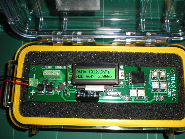

I didn't use the ADS1100, but did use the inbuilt A2D of a Pic18F2431 with 64x oversampling, a MPX4115 baro sensor and is good to about 35,000 feet for my rocketry altimeter.
I've attached a piccy..
