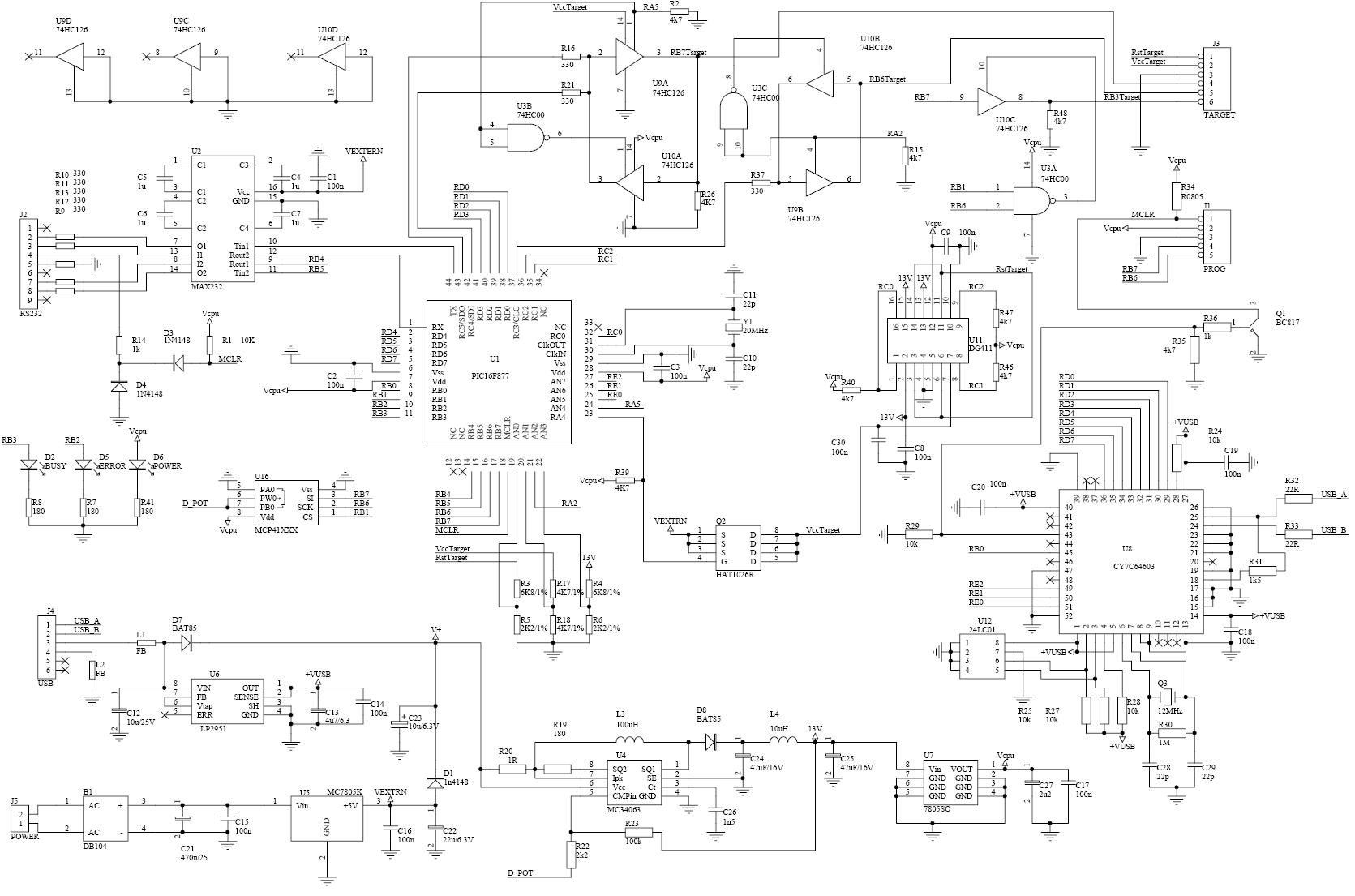

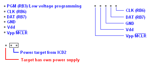

The attachments include a ziped Protel ddb document with the schematic and PCB layout inside,a JPG file which you can develope as a digital picture as a cover,another JPG of the original ICD2 sch,the PIC16F877A bootloader and a GIF explaining pin assignment over the PCB.

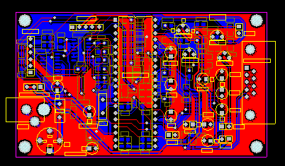

Here is what the Protel generated virtual PCBs look like(scroll down to the bottom):
