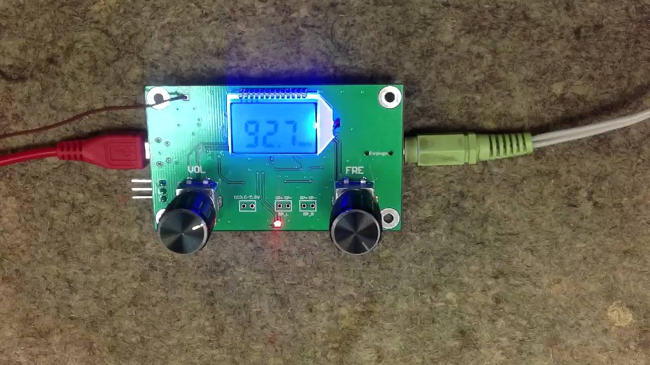

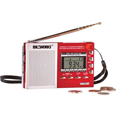

Am dissapointed by the need to have a live compfuser/microcontroller gadget to initialize operation on such a receiver. I have several 'digital' radio cheap receivers for 300m, 3m, shortwave, and when energized, always go to the tuning they were when turned off.
Why disappointed?, it's fairly obvious - you're replacing a LARGE part of the radio receiver by the computer, that's what allows the performance you get from something which costs very little (not counting the cost of the computer). The module itself is pretty 'dumb' so utterly useless without a computer.
As suggested, if that's what you require, then use a PI to drive it.
those are actually analog radios with digital controls. the demodulator for FM is a hard wired circuit, same for AM or SSB, this is why a good communications receiver is expensive, you need several different circuits to demodulate the RF signal. analog radios are often constrained to narrow receive bandwidths, listening on only one frequency at a time and very limited tuning range. SDR radios can take in a whole chunk of bandwidth (one of the ones i have can sample a 20Mhz bandwidth), and if you save all the samples to a file, and play it back later, you can listen to everything that went on in that 20Mhz slice of spectrum
