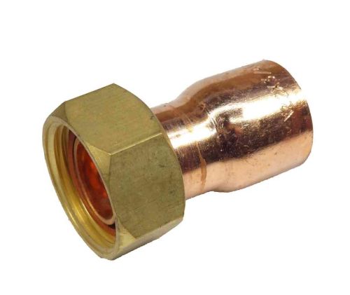

I am in Mexico for a couple more weeks and I've been looking at when threads are in use here. It seems to be a mix of NPT and G threads, so adapters might be common here. One option I see is to get G3/4" female copper sweat fittings and make adapters.

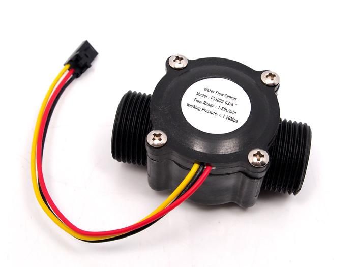

Here's a picture of the type of flow meter I'm looking at. These things appear to have pretty good engineering for the $10 price. The impeller spins a magnet, which is picked up by an external Hall effect sensor, so no seal to worry about.
Yes, I've played with that exact sensor - it simply connects with the old UK screw-on hose fittings - but everything now seems to be Hoselock, and 3/4" to Hoselock fittings are commonplace.
Here are the ones we use:
https://cpc.farnell.com/hozelock/2175/outdoor-tap-garden-hose-connector/dp/SI15639 there's a rubber seal in the adaptor, so no extra one required.
We don't use the white part, but I can't bring myself to throw them away, so I've got a fair pile of them now. Just don't lose the rubber seal when you unscrew the white part (and not notice) as it WILL leak with out the rubber seal.
Searching Amazon.com for something to fit the flow meter produces adapters for 3/4 "hose thread" - I think Les has found the compatible fittings, apparently garden hose connections in the US use 3/4" BSP the same as in the UK?
You may also find that a 3/4 NPT barrel connector fits straight on the plastic thread, though?
3/4" is also the standard for bath tap plumbing fittings in the UK - I have no idea what is used in the USA; are those also teh same?
eg.
ps. Those dowty seal washers are intended to go outside the thread of a fitting. Internal washer fittings generally use either rubber or fibre seals.
