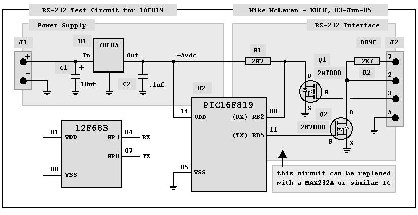

This is not the SparkFun circuit but it's the simplest and most reliable I've found using only four parts... I've only used it up to 115,200 baud...
Regards, Mike

I have some doubts with the pdf that you have posted. The signal TX on the header4 is connected to the output(collector) of a transistor. So I think it should be Rx instead but after I read the bottom of the pdf, it said TX is connected to the uP RX pin so no more problem there.

read the note right below the schematic in that PDF. it says that TX and RX are relative to the board... in other words, the RX pin connects to TX on the PIC, and vice versa.
the TTL signal for RS232 interfacing with "inverting" level shifters can be somewhat confusing, because the line should be normally high (when not transmitting) so you'd expect the logic to be active low, but it's actually still active high.

but if you do it with those logic levels, it will work properly with a MAX232 or those transistor circuits (for instance, notice how a logic 1 is +5v for TTL, and -10V for RS232... in the transistor circuit, a +5v signal to the transistor would pull that line DOWN to a negative voltage, therefore you know that the signals don't need any extra inversion)
Yes. My fault about the pdf. :oops:
Got it. Basically, the max232 chip do the inverting so replacing it with the transistor/mosfet would not induce any extra inversion so no manual inversion is required in the data before sending out to the UART.
