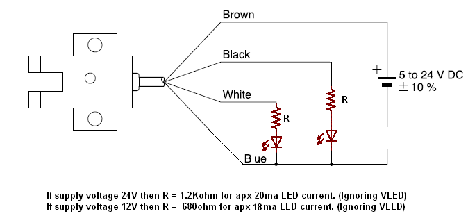

I am currently doing a task. I have a photo sensor with 3 terminals -> Signal wire and another 2 wires for powering. Note that the 2 powering is connected to a voltage source, and I want to use the signal wire to initiate an LED so that the LED lights on/ off indicated whether there is a signal detected or not.
Now this is the part, how can I use the Signal wire? Is it relevent to connect the Signal wire to a relay which will initiate the LED circuit? What type of relay should it be? Or there are other ways?

It looks like your sensor can supply 50mA for a relay. The sensor will run on any voltage between 5VDC and 24VDC. What voltage are you supplying to your sensor. What is the voltage and current of the circuit that you want the relay to switch. That should give us all the info needed to select a relay.
Ken
Voltage supply to my sensor should be 24VDC. The voltage for relay to switch to another circuit should be designated at around 2-3VDC and 15-20mA to go trough a LED so that it can light/dark out in reference to the photosensors.
I currently have a design in which a 24VDC supply is provide to both Relay switch circuit and Photosernsors. Voltage at the relay circuit part will be shared out by resistor orientated in series with the LED so that LED can have low voltage supplied.
If you need my design diagram i will draw one for you.
A drawing would be nice. At this point we looking for a 24 volt relay, with a coil resistance of less than 480Ω, or power consumption of less than 120mW (same spec' in different terms). We're getting there. The last two requirements are the switch contact configuration (the drawing will tell me that), and the physical case/connections type.

Suppose I have the circuit set up with sensor (24V,50mA) goes in parallel with a relay (24V, 480 ohm ) + a LED (2-3V, 15-20mA, power consumption 30-60mW).
2 questions from the above situation :
Is the design relevant? LED would not be functioning or either it is damaged isn't it? In this case I need to add a resistor?
Is the coil's self resistance going to affect the resistance of the secondary circuit? (note : primary circuit = sensor ; secondary circuit = LED)
If you just want to light a LED, then all you need, in addition to the sensor and power supply, is a LED and a resistor. You won't need a relay.
Yes, since the sensor can supply 50ma, it can drive a LED at 20ma directly:

Ignore VLED? any reason behind? Since the line at LED + R is in series at 24V shudn't both components share out the 24V (I thought we need atleast 2-3 volts to drive forward bias in LED)?
All I meant was that I ignored the LED voltage drop in the resistor calculations that I posted because I didn't know which LED you were using.
Different color LEDs have different forward voltage drops. A white LED could have a 3.5V drop where as a red one maybe 2V drop. So, for a red LED (2V) and a 1.2K resistor with a 24V supply, you would get (24-2)/1200 = 18.3ma current. If it was a white LED (3.5V) and a 1.2K resistor with a 24V supply, you would get (24-3.5)/1200 = 17.1ma current. You are not going to notice the difference of 1ma in LED current anyway and both values are within the spec of most LEDs.
BTW, I would go with the lowest supply voltage that is convenient, to minimize power dissipation in the LED dropping resistors.
