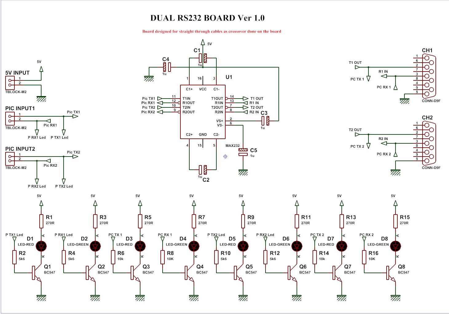

ok i admit 8 Leds is a tad overkill but this board in its defence is a general board i want to use for projects like debugging etc so i thought a led on each side will at least tell me if the program i have written on the pc side is working or if data is being sent from pic side etc, so its a kind of tool board rather than for just one project :D and again its for helping practice layout :D, and it was kind of dads idea he pointed out that one day i would have to be sensible and consider cost in a design,function,form and balance (not a clue what he was on about lol) but for now there is several thousand 3mm Leds in a box gathering dust (from when dad had the online shop) that cost next to absolutely nothing (most the stuff was ex bankrupt stock got really cheap from auctions) so i might as well use them to have fun and learn. but yeah i do take your point about blackpool! and dad also commented that the board had more bling than a council house chav!
as for voltage i will post the drawing its nearly done but i am only using the lines for the transistor base. interesting point about the -10V i will have a think about that and see if i need to do anything about it (design wise). i will monitor if it pulls too much and drags the voltage down but hopefully not at 1mA or there abouts, if it does i can always up the base resistor there is room in the cals :D.
as for the pulling lines down to GND when not in use, ok i accept that and have scraped the idea! anymore suggestions are very welcome. its great learning from the pro's, even if i do something that isnt the way it should be done (like blackpool light show) i do take notice and pay attention, it's stored in my book for when it matter's ;) so please dont think good advice is just ignored because it isnt
LG
there you go and i have resisted putting a power on Led in :D

The comment about Blackpool, was just a little facetious quip on my part, don't worry about it.
I understand all your reasons for designing the board as you have done, and they are all (well most of them anyway) good.
I have this nagging feeling that you may end up being confused by the LEDs on the RS232 side of the MAX232, I may be wrong, you will have to build it and see.
Can I suggest that you make test points for easy connection of scope probes, always useful if you are having a bit of a head scratcher. And while you are at it make a good solid point for the earth clip of the scope probe as well, in fact make at least two as you may need to connect some other test equipment there as well.
Big mistake, that is one LED that SHOULD be there if this is a test fixture.
A quick critisism, don't draw things the way you have drawn C1.
It spoils what is otherwise a well drawn schematic. Having said that, I have not checked it for electrical errors.

ahhhhhhh i moved the block and C1 didnt move GRRRrrrr i should have checked before posting!! well spotted jim thanks!, test points and earth connection will be added thanks for that i didnt think of it! but it has given me another idea!! will add the Led that should be there lol. i am hoping i can lay it out so the Leds make sense and also i am using green for RX and red for TX so if a green is on so should a red be at the opposite end of the board, havnt tried laying it out yet but would prefer if the leds were by the socket they belong too and pic inputs so its easier to see what the led is telling me. if it dosnt work then out they come on next board!
ok revised schematic
as it say's on the drawing, i have used both male and female single inline header's on the pic side of the chip. thats simply because that way i can connect just about any of my projects if needed and still have test points, only done one type pc side as obviously will only be using cable to connect from board to pc so it just needed to be a test point.
at the start of this i set myself the challenge of fitting it all on the offcut from the other board! its getting a tight squeeze now :D lol will post layout when done.
