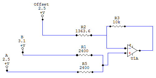

The formula is a sum-difference form of the function of your sensor inputs required to obtain your output, regardless of the op amp circuit resistor values. See attached. I assumed (perhaps incorrectly) you come up with something similar since you realise that you wanted to use a gain of four.
To start, 1.9 has to be subtracted from your sensor A (1.9 to 2.5v) output so that the circuit output starts from zero volts, giving a range of 0 to 0.6V. 1.9 must likewise be subtracted from your sensor B output (2.5 to 3.1v) so that it starts off from where sensor A output ends, giving a sensor B output of (0.6 to 1.2V). You then have as a result, a new offset voltage of 0.6 volts. To summarise in math terms we have: (A-1.9) + (B-1.9) - 0.6. We are not done, because you want 0-5V output, not 0-1.2V output, so that means applying a gain factor of 5/1.2 or 4.167 (your gain of 4 factor?). So then we have 4.167*[(A-1.9) + (B-1.9) - 0.6] which boils down to 4.167*A + 4.167*B - 18.333.
The only point I am making is that you will have to increase your negative offset voltage or apply gain to it to effect a largely greater subtraction term than you currently have. In your circuit configuration, that can be accomplished one way, by reducing the value of R3, but that also means adjusting the values of other resistor(s) to maintain the gain of 4 factor. It's a balancing act.
There are a few ways to configure such circuits. Here is one that should work. The two + inputs each have a gain of 4.167 (10K/2.4K) and the 2.5 voltage offset voltage has a gain of 7.333 (10K/1363.6) for an minus term of 18.3333 (2.5*7.3333).

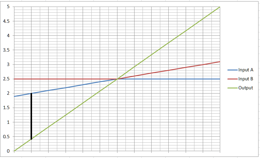

The A=2.V should be closer to 1V output, but you have the idea. My gain factor of 4 was derived from the 0.6V actual swing per sensor output versus the 2.5V (2.4 for an even number) desired output swing.
I mostly follow your logic, though I have no idea how to get to the starting point you used. Hopefully you can see how I got to where I was. When both sensors had the 2.5V input, I knew I had to subtract one out. Since the input range was 0-5 between the sensors, I didn't need much else. When the range dropped to 1.9-2.5 and 2.5-3.1 I could see that I needed to expand the range (apply gain) and hoped that I could apply gain to just the sensors. I know I could if I added an op amp with gain to each sensor before adding them, but I also knew that there should be a way to combine it into a single stage.
I don't understand why A=2 should be closer to 1V out. The attached graph shows that it should be less than 0.5.
Yes, that's another way of arriving at the same gain. 2.5/0.6=4.167

Quote ccurtis: There are a few ways to configure such circuits. Here is one that should work. The two + inputs each have a gain of 4.167 (10K/2.4K) and the 2.5 voltage offset voltage has a gain of 7.333 (10K/1363.6) for an minus term of 18.3333 (2.5*7.3333).
I did not follow the whole discussion (up to now) - however, the third sentence from ccurtis obviously is false.
The voltages at both + inputs are amplified by the factor
A=(1+10/1.36)*2.4/(2.4+2.4)=10.

As a matter of the output being a function of the inputs my "false" statement is correct. I don't understand the expression you provided to back up your claim either. Overall, the circuit most certainly does achieve the function (A*4.167) + (B*4.167) - 18.333 with 2.5V applied to the - input as shown in the figure provided, which is consistent with my supposed "false" statement.

(1+10/1.36)*2.4/(2.4+2.4)=4.176
is, of course, correct as it reflects the gain of a classical non-inverting opamp. However, there was a simple calculation error on my side which has led to the false result of "10" (see my posting '24).
However, I was (and still I am) somewhat confused about the resistor ratio 10k/2.4k you have mentioned at the end of your post#21.
Surprisingly, this ratio leads also to the correct gain of 4.176.
Please, can you explain the background of this ratio? I cannot recall any formula which supports this calculation.
Thank you
W.
I think the surprising result lies in the fact that this particular combination of resistor values is a special case. The parallel combination of the two 2400 resistors just so happens to be equal to the parallel combination of the 10K resistor and the 1.3636K resistor. For this particular function of the inputs that are given and the output the original poster desires, the resistor values just turn out that way. Most often it doesn't work out that way and my earlier statement explaining the gain and offset would indeed break down and not hold true.

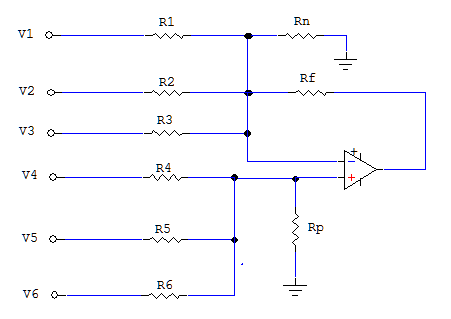

This is a design procedure for the attached general form of the circuit. Remove/add inputs as desired first and then follow the procedure, including or ignoring those inputs as appropriate.
1. Select a value for Rf.
2. Select resistors R1 thru R6 as if the gain for each of the corresponding inputs is Rf/Rx. Inputs connected to the - input subtract and inputs connected to the + inputs add. Thus:
Vout = V4*Rf/R4 + V5*Rf/R5 + V6*Rf/R6 - V1*Rf/R1 - V2*Rf/R2 - V3*Rf/R3
3. Calculate the equivalent parallel resistance of R1, R2, R3, and Rf. Call it Ra.
4. Calculate the equivalent parallel resistance of R4, R5, R6. Call is Rb.
5. If Ra > Rb, do not use Rp. Choose Rn such that Ra=Rb, where Rn is now included in the parallel resistance calculation for Ra above.
6. If Ra < Rb, do not use Rn. Choose Rp such that Ra=Rb, where Rp is now included in the parallel resistance calculation for Rb above.
7. If Ra=Rb, neither Rn or Rp is needed, but Rn and Rp can be included as long as they are equal in value. Including Rn and Rp in this case can provide a way to control the input resistance seen by the inputs to a degree.

Hi ccurtis,
thanks for the reply, however, I still cannot follow you.
Up to now I was of the opinion to be rather familiar with opamp circuits (since 25 years), but now I feel confused.
I kindly ask you to answer the following question:
I understand that the equation
Vout = V4*Rf/R4 + V5*Rf/R5 + V6*Rf/R6 - V1*Rf/R1 - V2*Rf/R2 - V3*Rf/R2
gives the output voltage for the circuit (shown in your last posting) as a superposition of all 6 amplified input signals.
Assuming that the signals V1...V3, V5 and V6 all are zero the equation reduces to
Vout=V4*Rf/R4.
Do you agree?

Added later: Possibly, now I can follow you. Is it correct that the formula for Vout as given by you - and, therefore, also the reduced formula (only V4 present) - are specialized formulas, which are suited only for the specific case that the condition Ra=Rb (as defined by you) is fulfilled?
Yes. The classical equations we know and love for inverting gain and non-inverting gain still apply. The OP's circuit requirements just so happens to result in a special case, where the classical equations combine and reduce down to a form such that the gain is Rf/Rx for both inputs of the opamp, which, admittedly, looks odd at a glance, since the classical form for the gain of an non-inverting amp is A(1+Rf/Rx), not just Rf/Rx; where A is a factor calculated using all of the various other resistors in the circuit.
Ccurtis, thank you. As mentioned already I am involved in opamp applications since more than 25 years (I was even teaching in this area), but - up to now - I never have heard about this method to design adding/subtracting circuits. However, I remember a contribution in EDN (or Electronic Design) several years ago, which might have described such a simplified method. But I didn`t see any advantages - thus, I didn`t read it in detail.
