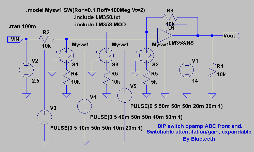

I have knocked up an 'analogue front end', similar to the ones used in Nigels PIC tutorials (not copying you Nigel!) to work on my experiment/dev board for PICs. Along with buffered inputs and available Voltage references, I added some resistors which can be switched to ground to provide selectable attenuation, and/or gain. Since each switch is single toggle, one can use DIP switches, which saves space, and makes for easy configuration. Four switches can provide 3 levels of attenuation, and 3 levels of gain. It's all very basic, but is there anything wrong with adding a resistor in the feedback path of a voltage follower? for when all switches are off? (basically a buffer) I realise this may add 'noise', but for 10-bit measurement, this shouldn't be much of an issue.
Criticisms welcome. Note: I haven't worked out resistor values for specific attenuation/gain, but I'm planning on basic gains of 1,2,2.5 (for a Vref of 2.5) and attentuation of 0.5 and 0.1. It all depends on the Vref used, to make ADC measurement calculations easier.
