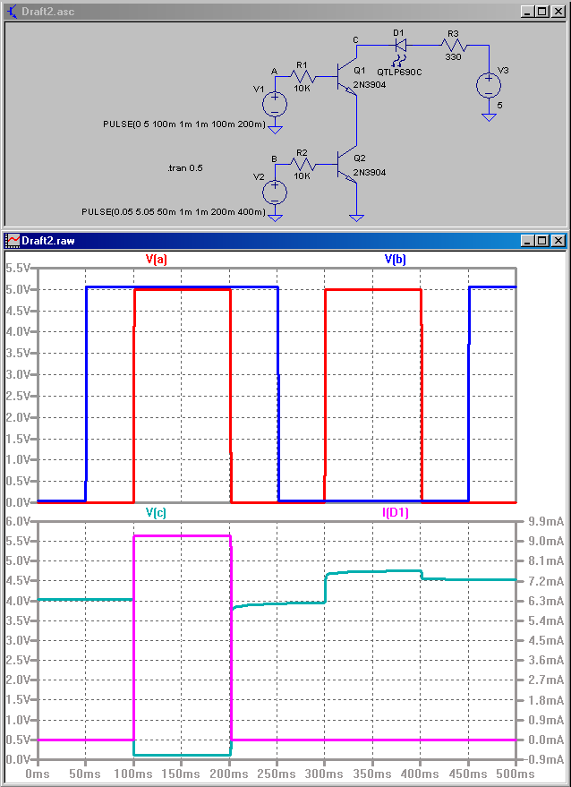

Here is a simulation of your (modified) circuit. I had to move the LED and current limiting resistor to the high-side of the circuit. With the LED in the emitter side, there was some leakage current through the LED even when it is supposed to be OFF. Note that current flows through the LED I(D1) only when both V(A) and V(B) are high at the same time.

I would follow Mike's circuit, your circuit is an emitter follower and if your voltage goes down to 3V then it will not work at all.
