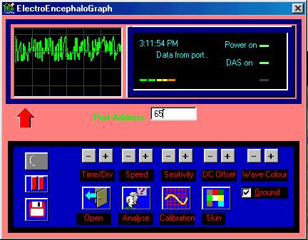

Hi
I have done a project which reads brain signals(EEG) and feeds to a PC. The software then plot the wave and analyse it. I developed the software in VB which can read parallel port plot, store and anlyse wave forms.
This software uses a DLL developed in VC to read parallel port, direct video memory access for fastest display and FFT algorithm to do forrier analysis of digital data. Signal from any port can be plotted with this.
I too had a plan of converting this setup to a PC based CRO. But the entire system is working well with low frequency only. For higher frequecies external memories are required.
See picture.
