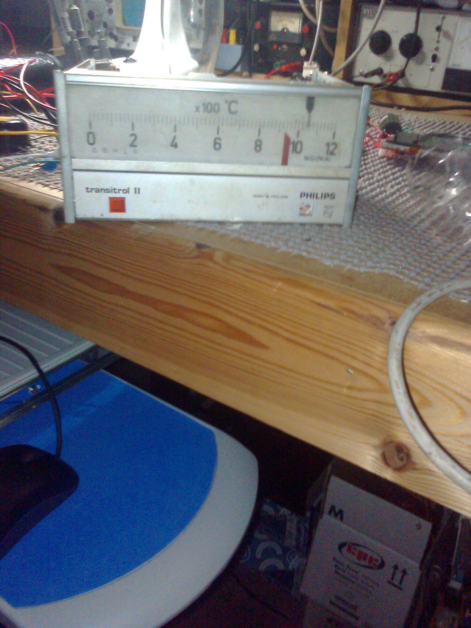

Found this at a junk sale, its a dc geared motor driving a sliding pointer through nylon strings as per old radio tuner scales, also on the pointer is a linear pot for feedback.
I attached said servo project to and it works, except in the centre of the scale the pointer tends to be unstable, maybe its tight at that point.
I think this was a thermal controler for heating ether, no idea what for.
