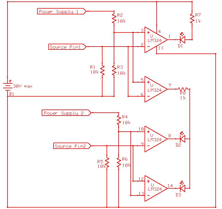

This may seem like a really stupid thing to ask, but I just can't seem to figure out how to get this to work. What I'm trying to do is take a comparator for a circuit that I later intend to make into an IC for myself and for sale. I have several problems that I can't seem to workout.
The way I want the IC to work is that there are 3 voltage supplies, one for the chip, one for the first input and another for the second input. That's the analog part. The voltage supplies for input 1 and 2 are for an internal reference for the comparator. There is an input pin that will either be connected to Vcc or ground to establish whether the inputs are a sinking or sourcing input (one for each). I can't seem to get the source/sink control pins internal circuit to work properly. I'm trying to use simple logic gates to power transistors for the comparator (because the actual input is still analog). I want the output of the comparator to be high when the input is respective to the source/sink control pin. IE: s/s High, input high, comparator output high, and s/s low, input low comparator output high.
My second problem is that I want the IC to drive both common anode and common cathode LED's. This is the part that has given me the most trouble. I want the output of the comparator to drive transistors or logic gates, something. There is a Common Anode Common cathode pin that will switch the outputs to their opposite state respectively.
Any help with this is greatly appreciated. I don't care what the inputs are, all I want is for simple logic gates only to be used.
PS: there are 3 outputs and 2 inputs

I got the idea from working with a MAX712 and an ICL7665. I'm just improving on the idea a little. Here are the schematics of what I came up with before. I didn't really know what to call them before, for now I'm calling them "LED encoders." Any other better names will be accepted. The third pic is of the desired block diagram. I understand that some of the features are complex, they can be skipped.

If I wanted to do it, I'd just build it using an LM324 rather than buying a more expensive proprietary IC. I would also add some feedback resistors to introduce hysteresis.
That's what I did, I'm just looking to make it a little... smarter. I did add a few simple extra's so that it can work with a micro controller. However there is one thing that bothers me (besides what I originally posted) I can't find a constant current source for the internal circuit (I have the one for common cathode but not common anode).
I suggest you read up on comparators before embarking on making a custom IC. Try building it in a simulator first. Also why 30V why not a lower voltage?
I know about comparitors, I'm talking about the input of the IC being connectd to ether a pull up or pull down resistor for the sinking or sourcing input. I was going to do it in a sumulator, but I needed to wait until now to gain access to the simulator, The reson for the High input voltage is so that the IC can work with just about any other external part.
You can download the free LTSPICE or trial Electronics Workbench (I forget what it's called now) And... What is the purpose of this IC (IE who / what would need it)

I have figured out the entire circuit except for the constant current source for the common cathode LED, I already have one for the common anodode LED. Please help me out with this minor detail.
