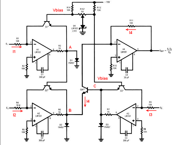

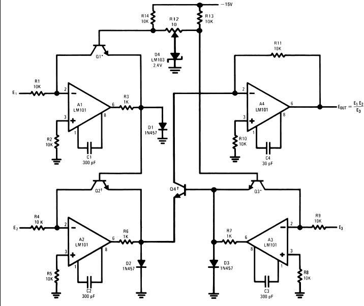

Hi friends!!! This is one of the projects handling by my class as mini project. But unfortunately working of this circuit(analog multiplier) is not getting for us. Please help us in solving it.

If We design the circuit, why I ask its working to you?? ;) . It multiplies the voltage E1 and E2 and divides the voltage E3. so, result is E1.E2/E3. It uses the log properties of transistors(most probably gummel plot). we try to simulate it before making the hardware, but again a problem. We use pspice student version and it didn't support for this diagram(no. of nodes are more than its limit).

Actually my question is not to find wrong in schematic. Question is please explain the working of analog multiplier provided schematic there.

I recognize that as a National Semiconductor schematic.
In a BJT, Ic≈Ie=Is*(e^(Vbe/Vt)-1)), the well-known diode equation.
For Ic>>Is, Ic≈Is*e^(Vbe/Vt)
Ic/Is=e^(Vbe/Vt)
Taking the log of both sides,
Vbe/Vt=ln(Ic/Is)
In the attached schematic,
V(A)=Vbias-Vt*ln(I1/Is)
V(B)=Vbias-Vt*ln(I1/Is)-Vt*ln(I2/Is)
V(C)=Vbias-Vt*ln(I3/Is)
Vbe4=V(C)-V(B)
substituting,
Vbe4=Vbias-Vt*ln(I3/Is)-(Vbias-Vt*ln(I1/Is)-Vt*ln(I2/Is))
simplifying,
Vbe4=Vt*(ln(I1/Is)+ln(I2/Is)-ln(I3/Is))
Vbe4=Vt*ln(I1*I2/(I3*Is))
From the diode equation,
I4≈Is*e^(Vt*ln(I1*I2/(I3*Is))/Vt)
I4/Is=e^ln(I1*I2/(I3*Is)
ln(I4/Is)=ln(I1*I2/(I3*Is))
I4=I1*I2/I3
Since R1=R4=R9=R11=10k,
Vout=V1*V2/V3
Q.E.D.
I hope I didn't make any typos.
EDIT: In order for Is to drop out of the equations, all transistors must have equal Is. Therefore, they should all be on the same chip, such as a CA3046. I suspect the asterisks on the schematic refer to a comment in the original app note to this effect.

You're correct about the circuit is from NS application note. It is AN4-6 dated April 1968.
Other points to note are:
(1) the circuit gives 1% accuracy for 500mV to 50V input, so input lower than 500mV has bigger inaccuracy
(2) the "*" on the transistors are described in the AppNote as "should be of the same temperature"
(3) the transistors should be installed with short leads and no socket as lead resistance even as low as 0.25 ohm can affect accuracy
The op-amp used is ancient, use a modern instrumentation quad op-amp.
