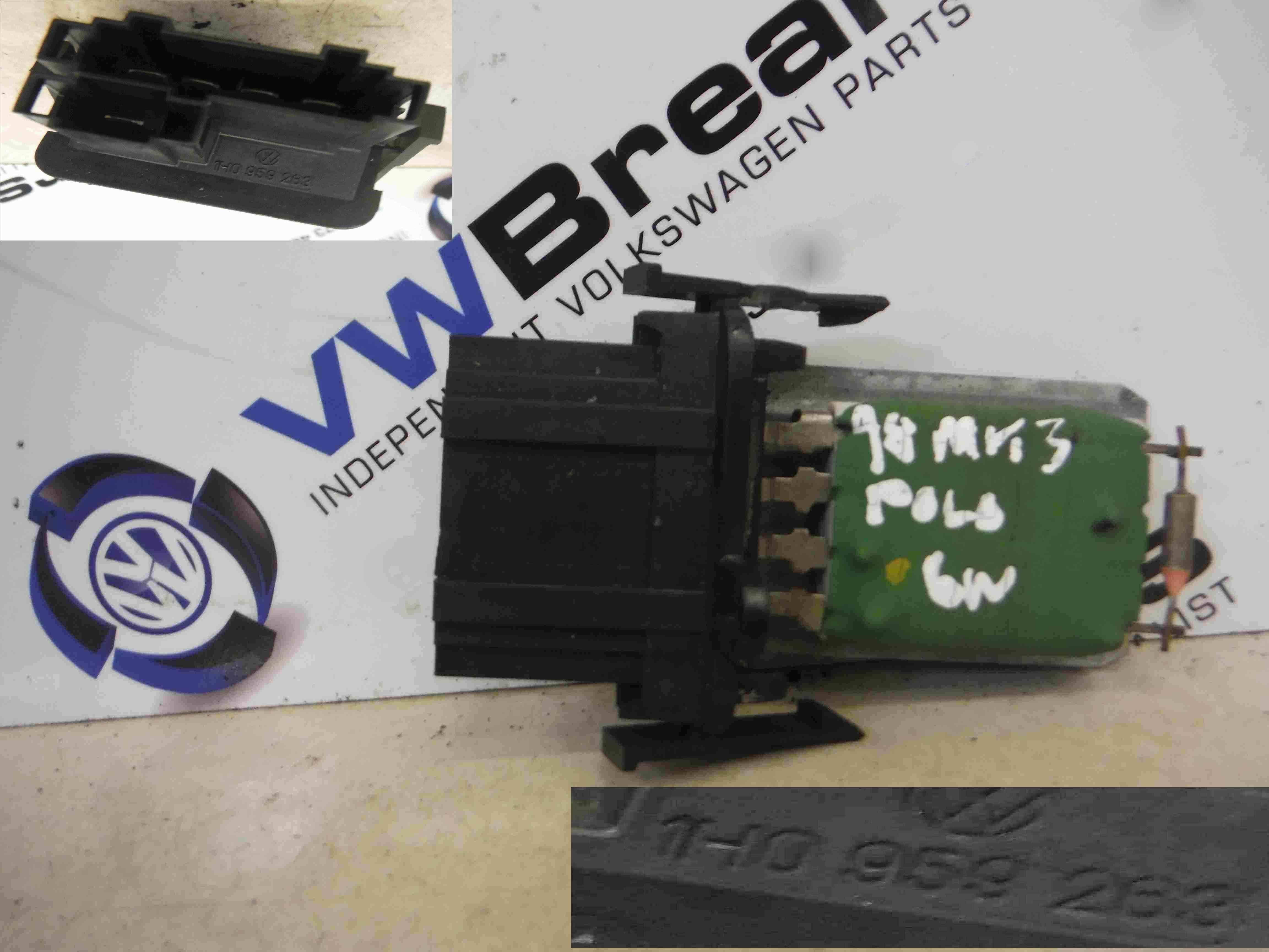

Looks like this
Completely separate to the blower... The diode is at the back... It will be in the air flow somewhere..
I always put diodes in series... Manufactures never allow for motor wear.. They always assume you'll replace it.. My last polo worked for years after I upgraded the diode.. Get two 10A diodes and parallel them up...

I hope you're not talking about that thermal fuse -- that's not a diode!
LOL!! That must be why it worked so well!! I've always thought it was a diode.... If this is correct, a thermal fuse will blow again... so a diode will work as I said... Otherwise, its a new fan unit!!
