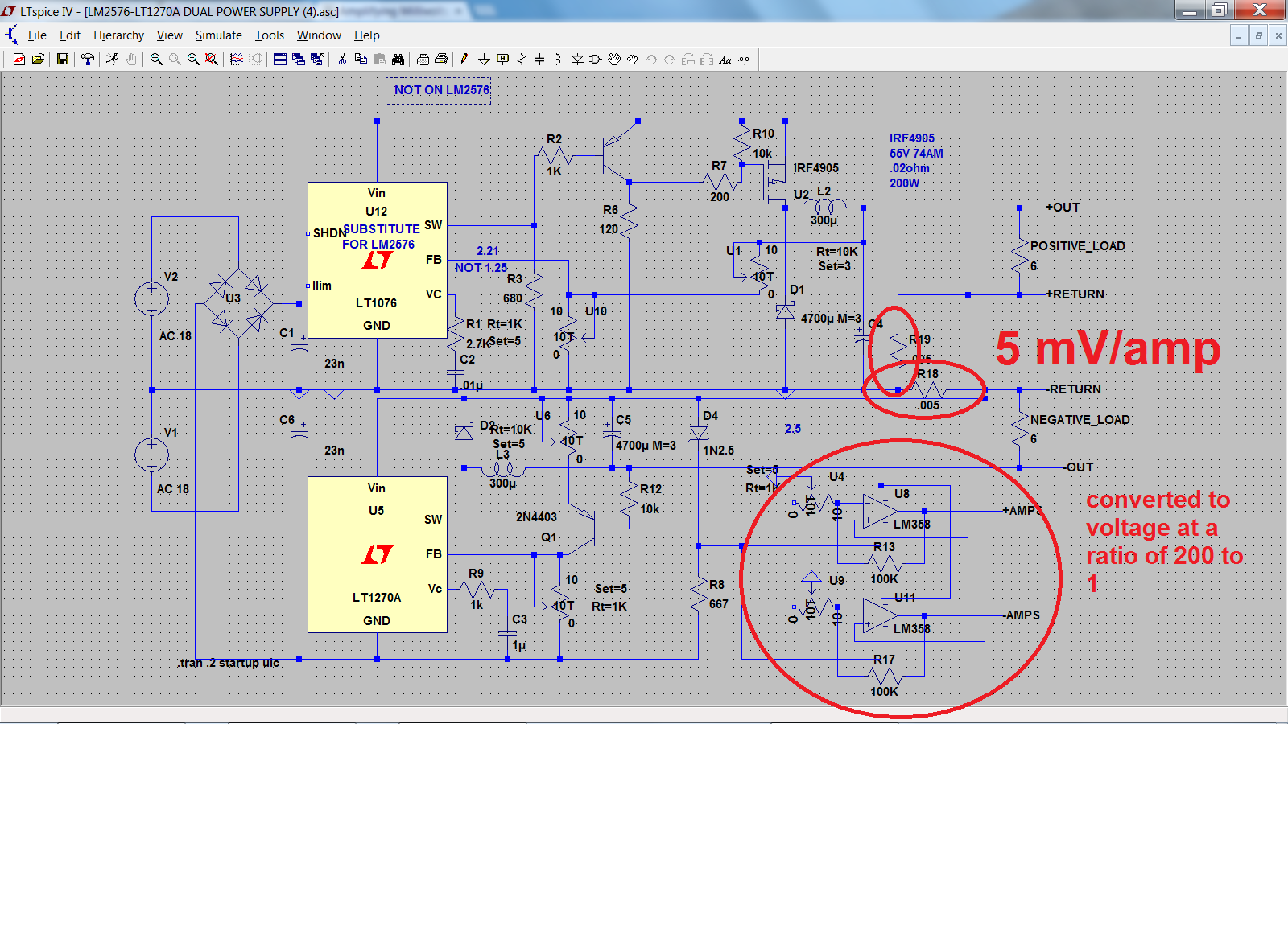

Hi guys, I trying to amplify 10 millivolts into 1 or more volts I was wondering if anyone knew how to do that. I'm really in a rush so please resond quickly.
I kind of depends on where it's at in you circuit, can you post your circuit?

OpAmps come to mind...
What do you have to work with?
Supply voltages?
What input impedance?
What does the output need to drive?
Bandwidth?
Have a look through datasheets of instrumentation amplifiers (posh opamps ;) )
You need to make sure they have a very low offset i.e. 0.1mV or lower - that would give you around a 1% error on your 10mV input.

Power conversion is correct. But you need to understand that you cannot increase power by converting it. All you can do is change the voltage and current numbers. But the power (volts * amps) stays the same or, more accurately, you get less power out due to losses in the power conversion process.
A standard USB port is 5V @ 0.5 Amps or, 2.5 watts. If you want to create that same power from a 10 mV source, you will need over 250 amps at the input.
