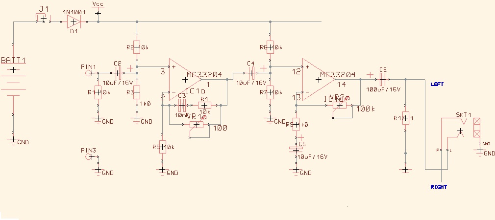

Attached is a battery powered bass amp I designed for an MP3 player. The first stage amplifies the bass, the second stage acts as a volume control, but does not amplify the dc. You can use this as the basis of a bass amplifier
I know you are right about the efficiency of a loud speaker. When I was going through the training school of my first company, the head of training designed the amplifier in the Odeon Leicester Square. The amplifier there is only about 20W, but have lots of volume because the loud speakers are very efficient (about 45%)
Yes, many of the cinema (movie house) speakers were loaded by a huge horn. This matches the radiation resistance of the speaker cone to the radiation resistance of air and produced an effortless expansive sound that you only normally expect from a live concert.
