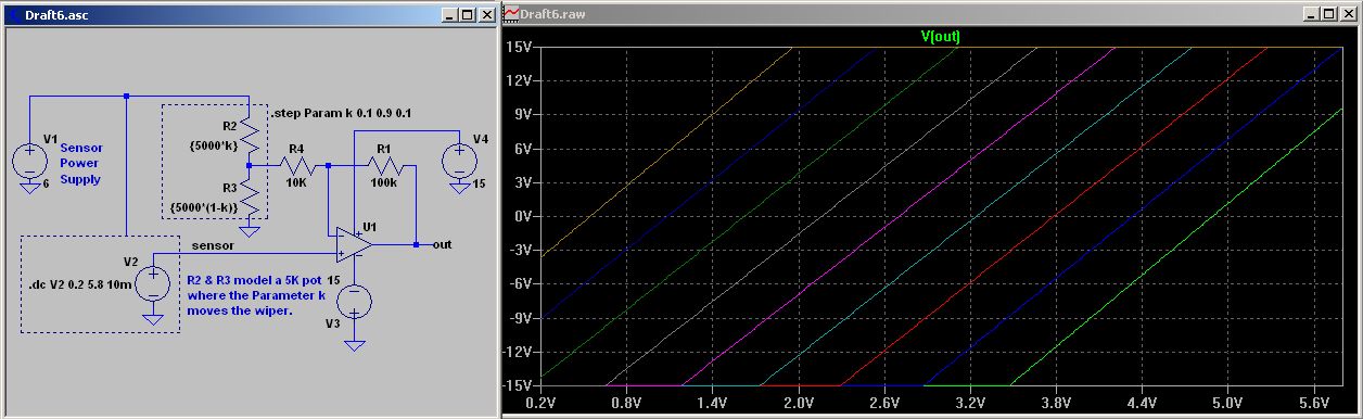

First, the data sheet says that the output of the sensor can be from (Vss+0.2V) to (Vcc-0.2V), where your Vss=0V and Vcc=6V, so the signal can range from 0.2V to 5.8V. If you want to amplify the sensor output with a gain of ~10, then you will have to bias the amplifier so that it amplifies a small subrange of sensor's full range.
In the sim below, I show how to use a pot to select which part of the sensor's output range gets amplified. Note that the pot is powered from the same voltage as the sensor. The horizontal axis of the plot is the sensor output. The vertical axis is the opamp output. The various traces correspond to different values of k (pot wiper position). Pick the pot position so that the sensor output is centered near zero volts out of the opamp.

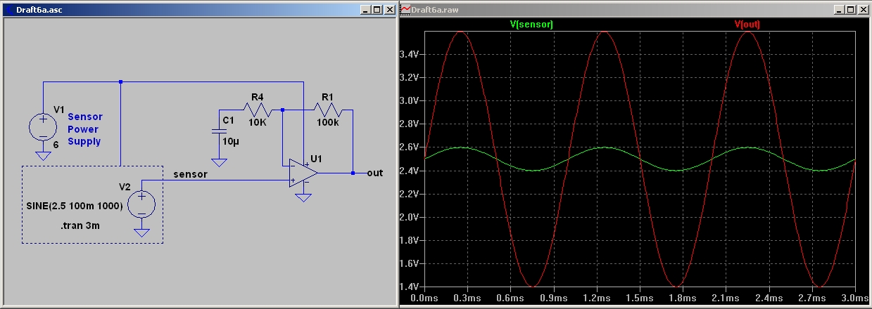

Here is my favorite non-inverting, ac-coupled gain amplifier. If you use a modern single-supply rail-to-rail opamp, you can power it with only the 6V sensor supply; no +-15V supplies required.
