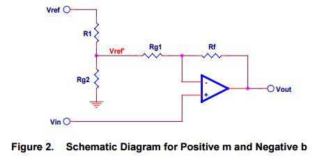

Start reading at post#68 in this forum thread. A bit simpler than your post #6.

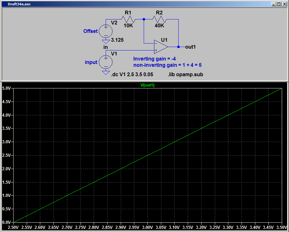

Gain = (5-0)/(3.5-2.5) = 5
Gain of a non-inverting amplifier = 1+R2/R1, so R2/R1=4
Pick R1 = 10K, therefore R2=40K
Middle of V(in) input range = (2.5+3.5)/2 = 3V
Middle of V(out) output range = (5+0)/2 = 2.5V
(V(ref)-V(in))/R1 = (V(in)-V(out))/R2
Subst, and rearrange, V(ref) = (R1/R2)*(V(in)-V(out)) + V(in) = (10K/40K)*(3-2.5) + 3 = 3.125
