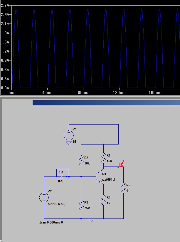

amplifier only works half cycle. Why?
Why is the circuit that i've rigged up in LTspice only conducting for half cycle in the output current shown in the red arrow point?

The 2.6 amps is measured across R5. I've shorted the input capacitor, if you noticed and if that's not shorted i'm getting 2.56 mA, as opposed to 2.6 A peak with shorting that capacitor
Also I have used a transistor spice model downloaded from ON semiconductor website! If I replace it with a 2N222, then I only get milliamp range of current!

With the capacitor missing you should only see slightly less than 1/2 of the sign wave. (just what you have)
The transistor can not amplify the input signal that is below ground. (in this case below +0.6 volts) There is a reason for the capacitor. Put it back in.
The type of transistor is not the problem.
The transistor can not amplify a signal below ground. The capacitor is there to block the DC and move the signal up in voltage to a range where the amplifier can work.
I don't like the value of R3 (25k). I think you should put the capacitor back and change R3 to 5k.

The model is probably fine. The circuit is F$&*!~U@.
1) That amplifier can not drive a 1 ohm load. (remove R5)
Why is your Load Resistor (R5) Only 1 Ohm?.
It is Shorting Out the DC Collector Voltage.
2) Put C1 back in.
3) The bias is wrong.
change R3 to 5k

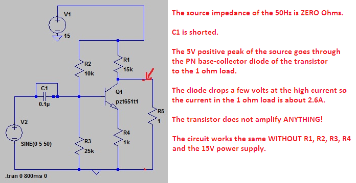

I have a simple explanation here:
Thanks AG!!
I knew that when you would see the circuit, you could spot immediately the error!

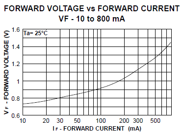

Since V2 is 5V peak and R5 is 1Ω, with C1 shorted out the peak theoretical current flow via the collector-base diode of Q1 will be ~ (5-0.7)/1 = 4.3A.
Your theory doesn't work when the base-collector diode current is extremely high.
The simulation shows that the forward voltage of the base-collector diode is 5.0V - 2.6V= 2.4V (!) which makes the current be 2.4A.
It does for a theoretical transistor whose bc diode drop is independent of current (but not for a practical transistor) :D

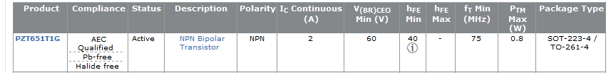

A 1N4148 is a silicon diode that is similar to the base-collector diode of that tiny surface-mount transistor.
Its forward voltage is typically 0.7V when its current is only 5mA.
It can survive 1A for one second but the datasheet graph stops at 800mA when its forward voltage is typically 1.45V. It might be 2.4V or more at 2.6A.
Its maximum allowed current is 4A for a very short duration.

with the short across the input capacitor, the transistor is not properly biased. the internal resistance of the LTSpice signal source is ZERO ohms. remove the short from across the capacitor.... it's not an incompatibility of LTSpice or any of it's models. when you put the short across the capacitor LTSpice is only doing what you told it to, and creates a zero ohm DC path to ground. remove the short from around the capacitor..... R E M O V E T H E S H O R T...............
