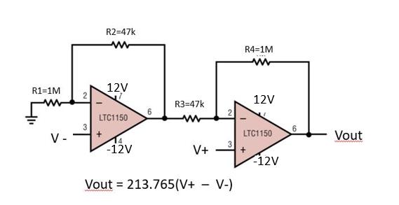

I found an amplifier board which was made by someone else several years ago.
The function of this board is to amplify the output signal of a linear displacement sensor in a tensile testing system.
The schematic is shown below.
The ideal gain is 213.765 by using the equation Vout = (V+ - V-) *(R1+R2)/R2 with R4=R1 and R3=R2.(typo, R1=R4=10M actually)

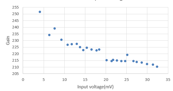

However, I made a simple measurement and found that as the input voltage(V+ - V-) increases, the gain decreases.
There are two sets of instrumentation amp in this board, I test both, and they both show above phenomenon. So I don't think it's the board's problem, I think there must be something I did wrong which lead to this strange result.

5. I change the signal output of the displacement sensor(input to the amplifier board) and measure the output of the amplifier board, then calculate the gain.
Could anyone tell me what I did wrong? Why the gain is not stable?

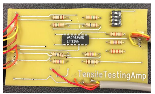

The photo shows a lousy old LM324 with plenty of input offset voltage and the schematic shows LTC1150 opamps that have sample and hold circuits that cancel any input offset voltage. A HUGE difference.
The LM324 cannot use resistors with a value as high as 10M.

I am so sorry for the confusion. The opamp actually is LM324. I grab the schematic LTC1150 from internet.
The real board contain two sets of the schmatic circuit, one is used to amplify the displacement signal, the other is used to amplify force signal. The board circuit and schematic is the same. Not quite understand your word" huge difference".
I measured the resistance of these resistors on board without desolder them. The R1 is around 6M, and R4 is around 2.5M.
But based on the color code, they should be both 10M.
The LM324 quad opamp is cheap, old and has poor performance. The LTC1150 opamp is much better and they have a HUGE difference in performance in that circuit that is designed to use the LTC1150 opamps.
The larger photo you posted on the other website shows that the cheap carbon film resistors are damaged. Undamaged metal film resistors will be more stable.

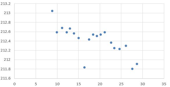

You are correct, it is the offset problem. I substract the initial offset and calculate again, I got the following result which improved a lot.
You teach me a class. Initially I ignored the offset because I thought 70mV is too small comparing with several voltage output, later when I drive back home, I suddenly realized that the input is on the mV scale. After I did the calculation, I got the correct result.
