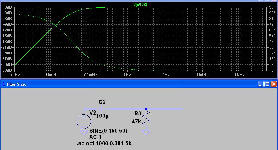

Sorry about that, I found the current gain to be 150 but still do not understand ultimate rate of attenuation, low-frequency breakpoint and the mid-band
Obvious. I thought that everybody knew the rate of attenuation of an ordinary CR highpass filter. I also think that the "breakpoint" of an RC filter is known by everybody.
Now that the current gain is known, the input impedance can be simply calculated.
A signal with frequency f = fo = 1/2πRC is attenuated by 3 dB, higher frequencies are less attenuated and lower frequencies more attenuated.
Have you covered this?
Do you know what the slope of the curve is?
Here is 100uF and 47k ohms. -3db is about 0.03hz. Do you agree?
What is the slope on the left side? (db/decade)
