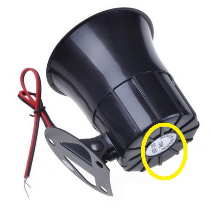

I am confused about the amperage draw of a 12 volt siren. The box reads that it uses 320 mA (high-low sound); however, the siren has a stamp reading 15 W. If the siren uses 15 watts, shouldn't the amp reading be 1.25 A (15W/12V)?

Your logic and calculations are correct.
However, as that appears to be a cheap item made in China, I think that you can take the specifications with a pinch of salt.
If the 320mA is correct (probably is not), the 15Watts is just wishfull thinking like many cheap audio devices.
Id believe the current draw not the wattage.
The Chinese siren is stamped "15W" which is 15 Whats, not 15 Watts.
Maybe its amplifier is a single class-A heating transistor that produces 12W of heat and 3W of sound power.
Could be that the sound producing component (siren element) is rated at 15W (1.25A), but is only being driven by a circuit that combined uses 3.64W (320mA).

No argument with Ron here, however a 15w in audio watts siren would be very large and terrfically loud.
Speakers are probably less efficient than a transducer for an alrm sounder, howevr the average speaker is only around 4% efficient.
The siren does not use an ordinary inefficient speaker, instead it uses a re-entrant horn that makes it VERY efficient over a narrow frequency range and it is very directional.
I agree that it is not very loud unless you wear it on your ear:
110dB at 1 foot, 104dB at 2 feet, 98dB at 4 feet, 92dB at 8 feet, and only 86dB at 16 feet. That is for its peak sound level at only a few frequencies.
