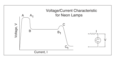

Those small lamps need about 75 volts before they will strike, ie light up.
When they are lit up, the voltage across them is usually about 60 volts.
This is why you need the resistor, to "soak up" the difference in voltage between the supply and the lamp.

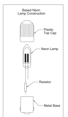

The resistor that is already in series with the neon will have been selected to limit the neon current to a suitable safe level. Don't be tempted to change it.

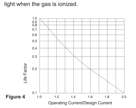

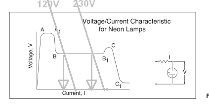

If a value of 150k is used for both 120Vac and 240Vac, the voltage across the tube will be constant and thus R controls the current which affects the glow brightness. Doubling the current in the B range ( such as operating from 240V) will reduce the lifetime to 10% of the expected 30kh or 3kh.
In theory you can operate 2 tubes in series with one smaller R, but the brightness and life expectancy would vary greatly with line voltage which must be a lower tolerance like 115~120Vac
Here the slope is 150k
