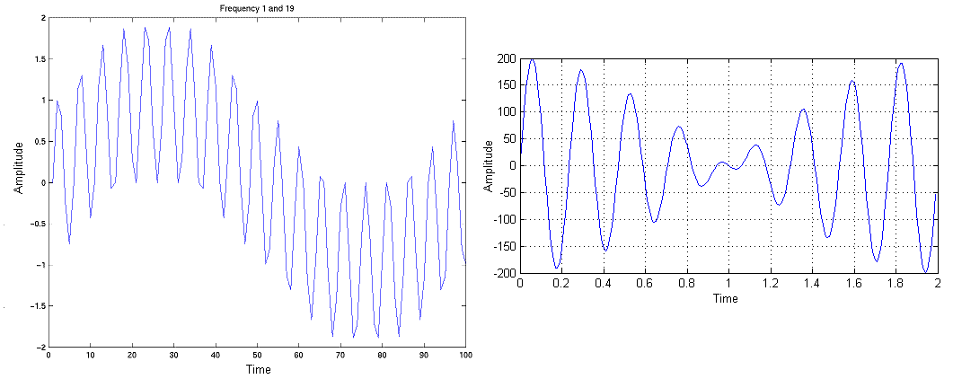

To modulate a signal you need some form of analog multiplication. An op amp can add two signals together but that is not modulation.
The ring modulation waveform looks like amplitude modulation.
I am confused. Frequently I have mains hum from an audio circuit and it adds to look like the left graph which looks like a beat note is not formed. But amplitude modulation multiplication looks like the right graph where a beat is clearly visible and will be audible.
Which graph actually shows adding and which graph shows multiplying?

The picture of the ring modulated signal shows double-sideband suppressed carrier AM modulation. A 4-quadrant multiplier can generate that type of modulated signal.

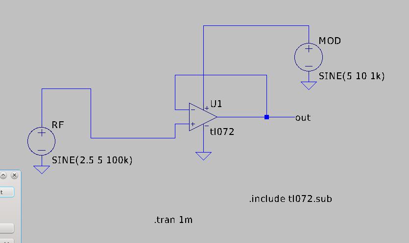

i like the chip, but i found this circuit:
would it work?
i dont understand "modulated clipping level", but i do want it to multiply with the signal (smoothly) maybe just stick with the chip eh?

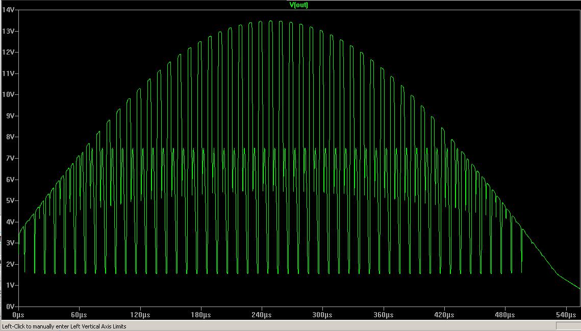

that's a mixer circuit, and not really a modulator. by "modulated clipping level" i mean that the op amp would create a square wave output, with the point where the distortion occurs changing with the modulation input.
notice the very bad distortion of the modulated RF
