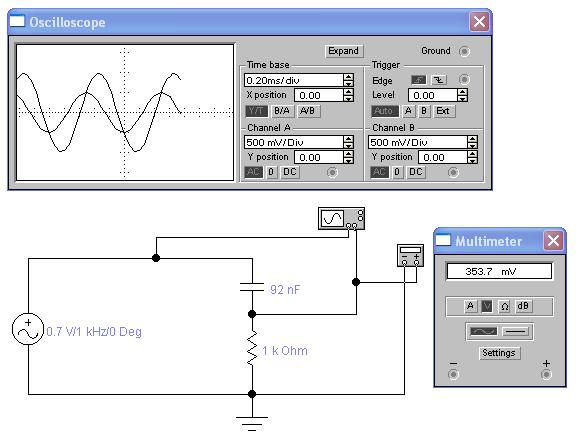

I know why i got 92nf now, i was using the input as 1v RMS. When you feed in 1V RMS you get 0.5v RMS out, with a 92nf cap and 1kohm, @ 1khz :D

My simulator gives out 0.5V RMS, with an input 1v RMS?

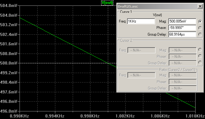

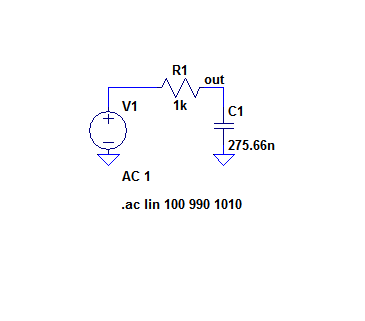

And your simulator is either wrong, or you are using it wrong, or misinterpreting it. Can you post the schematic and the waveform (or Bode plot)?
Below is a sim from SwitcherCAD.

I would appear that the difference is whther you take the output across the resistor or the cap. I'll do the maths and see if I get the same answer as Ron if the output is across the cap.
I transposed the R and C and re-did the maths. This way, the answer is 275 nF as Ron said.
So we are all right! (except your teacher)
I had a feeling that the Xc of the cap would not = 1 k for the output to be half.
The relationship between the supply voltage and the voltages across the R and the C is not linear. They are related by Pythagorus (I'm not sure about the spelling)
Len, you're right. Megamox, please accept my apologies. As Len said, I assumed the lowpass configuration. I think the original wording implied the highpass config, which I didn't even consider. I guess I was only half wrong. :oops:
