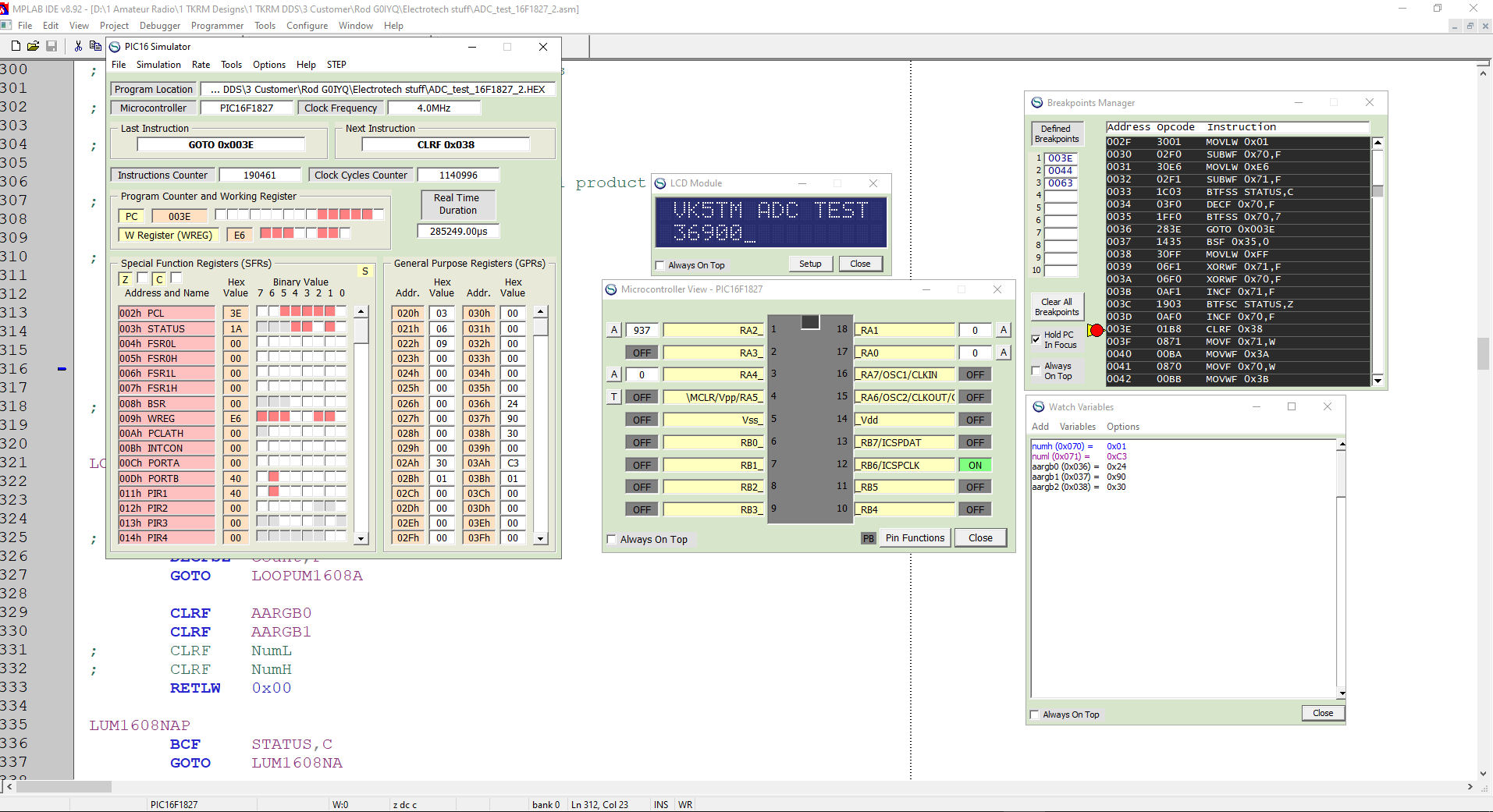

I can't get to the workbench at the moment, so fiddling around with the Oshon Sim and code re my ADC scaling thread.
I have been fiddling with the multiply word (NumH,NumL) by 56 and divde by 10 thing as the sim doesn't like Mikes table code.
So if my maths is correct 451 x 56 (dec) = 25,256 (dec)
Using Microchips AN617 16x8 Bit Unsigned Fixed Point Multiply routine, I am getting 451 x 56 = 36,900 (code below).
BARGB0 is loaded with 56 (dec), TEMPB0 is loaded with NumL & TEMPB1 is loaded with NumH which for the purposes of this calc = 451 dec (using any other numbers in NumH:NumL gives corresponding errors).
;       16x8 Bit Unsigned Fixed Point Multiply 16x8 -> 24
;       Input:  16 bit unsigned fixed point multiplicand in AARGB0
;                       8 bit unsigned fixed point multiplier in BARGB0
;       Use:    CALL    FXM1608U
;       Output: 24 bit unsigned fixed point product in AARGB0
;       Result: AARG  <--  AARG x BARG
;       Max Timing:     5+119+2 = 126 clks
;       Min Timing:     5+54 = 59 clks
;       PM: 5+26+1 = 31              DM: 7
FXM1608U        CLRF    AARGB2          ; clear partial product
                MOVF   AARGB0,W
                MOVWF   TEMPB0
                MOVF   AARGB1,W
                MOVWF   TEMPB1
                UMUL1608L
                RETLW           0x00
UMUL1608L        macro
;       Max Timing:     2+13+6*15+14 = 119 clks
;       Min Timing:     2+7*6+5+4 = 54 clks
;       PM: 26            DM: 7
                MOVLW   0x08
                MOVWF   LOOPCOUNT
LOOPUM1608A
                RRF     BARGB0, F
                BTFSC   _C            ;--> _C = STATUS,C
                GOTO    LUM1608NAP
                DECFSZ  LOOPCOUNT, F
                GOTO    LOOPUM1608A
                CLRF    AARGB0
                CLRF    AARGB1
                RETLW   0x00
LUM1608NAP
                BCF     _C
                GOTO    LUM1608NA
LOOPUM1608
                RRF     BARGB0, F
                BTFSS   _C
                GOTO    LUM1608NA
                MOVF    TEMPB1,W
                ADDWF   AARGB1, F
                MOVF    TEMPB0,W
                BTFSC   _C
                INCFSZ  TEMPB0,W
                ADDWF   AARGB0, F
LUM1608NA       RRF     AARGB0, F
                RRF     AARGB1, F
                RRF     AARGB2, F
                DECFSZ  LOOPCOUNT, F
                GOTO    LOOPUM1608
                endm
Screenshot of the sim result with the registers in the watch window lower right.

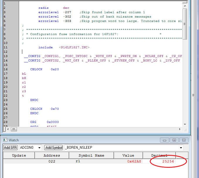

I never had much success with the microchip routines so I dug out an old one I used many years ago,
This is the result in MPLAB v8.92 - the old one.
As you can see it gets 25,256 as the result.

Did a little bit of "research" and appears a few people have had problems with the AN617 routines. Looks like their app notes are vetted to the same level as their datasheets - poorly.

One thing to be aware of is that many of Microchip's math routines were originally written for their very early processors which behave slightly differently than the later ones. In particular, the operation of the carry bit has changed from the early to later processors, and that can result in incorrect calculation results when used with the wrong processor. It's possible that they've re-released some old routines without properly vetting it for proper operation on current processors.
