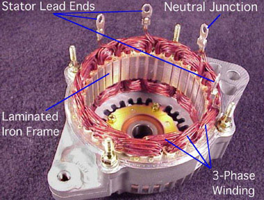

I have just blown my second alternator in 3 years. Its the type that the field winding is controlled by the engine management chip.
The controller is OK I'm thinking but the two alternators show different signs and I am trying to get one to work.
"A" gives an output voltage of up to 18 volts when run as fast as my drill can turn it and the field is taking about 4 amps directly through my bench supply at 12 Volts. Can't get it over 18V but my drill is a bosch 1200 watt on 240 V so I guess its doing about 900 rpm or less
"B" gives no output at any speed and takes about the same amperage through the field winding .
I have checked all the diodes and all seem to be working fine.
I have noted that on "B" None of the windings show a resistance at all and show continuity with a buzzer. I havn't checked "A" diodes again but they seemed OK the first time I checked them. However the windings again gave no resistance however I checked them , just continuity.
Can anyone lay out a definitive check routine so I can locate the faults?
With the 3 windings being joined at the star center I would have thought some sort of testable resistance should show if I can get continuity between any two windings

Well thanks but not much gained there. Alec-t I need to find then that resistance to be sure it is not shorted out between the static windings. How can I do that with a cheap multimeter? I need to see a resistance for each coil.Its a wye formation I think .

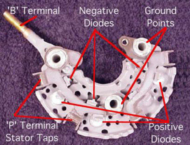

How in practical terms can I check the diodes? I'll try attach a picture of the bridge . What do I check where? I could only find one with 6 diodes . Mine has 8

You could disconnect the rectifier and measure the AC voltage between the three ends of the windings.
Les.
Thats doable but dificult but what a/c voltage could I expect then . At the same revs i would expect about 18V also ? I suppose if it were a lot higher that might indicate a diode bridge rectifyer problem though Hmm .

Does anyone else have any suggestions as to how to test the diode bridge shown and be sure it is right?
Its not easy to work out which diode is connected to which and which are positive and which negative. They are all in conducting and non conducting layers and coated with a ceramic layer for heat protection

Generally, you would disconnect the diodes from the alternator coils and test each one in the forward and reverse directions using the diode test on your meter.

Once you have the bridge out, the diodes are connected in a fashion where they can be tested. You just have to be able to locate both ends.
So, Diode test each diode, in both directions and record the results. If you don;t have a diode tester, then use a 9V battery, a 1K resistor and a voltmeter.

Test the diodes in both directions and record Vf. provide that table and we can go from there.
Swap the bridges and see if the problems switch positions.
