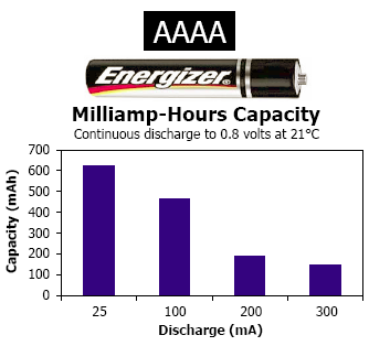

If you strip a Duracell 9 volt battery you will find it's conposed of 6 thin and long cells. They are about half the diameter of an AAA cell. You can use 3 to get the 4,5v needed.
A new 9V alkaline and Ni-MH battery has six skinny AAAA cells. They have hardly any capacity but tiny button cells are worse.
