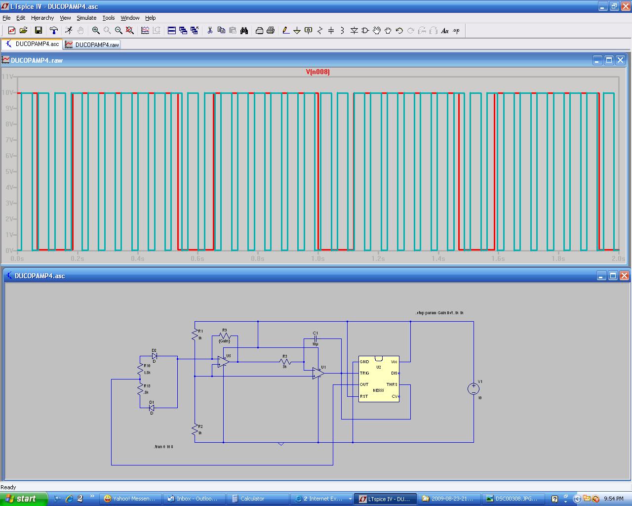

There have been a couple ideas posted on how to do this. Attached is my idea. It works in simulation, but I haven't tried building it yet. Have other projects on my bench right now. R10/R13 are intended to model the variable resistor used for duty-cycle adjustment. R9 is for frequency adjustment.
