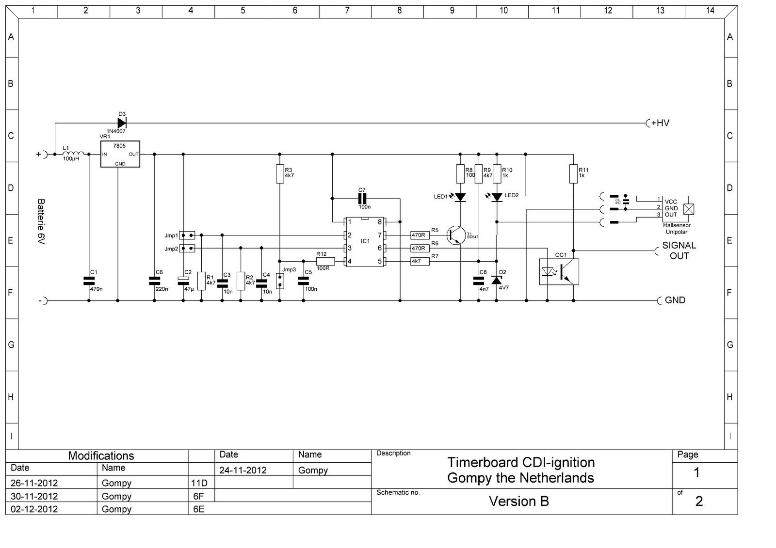

Hi
Made a bit more progress.
Using a islv9v3036s igbt I connected a coil and spark plug last night.
I get a few sparks and then it stops. Looks like a spike caused by the inductance of the coil is upsetting the PIC.
If I bypass the PIC and drive the IGBT direct from the 555 timer circuit I get a good spark.
Any advice would be most welcome.
Don
Please post your circuit here.
You will note that many of the more developed circuits presented in the above links use optical isolation. It doesn't take much kick from a coil to kill a PIC.
John

Here is another Gompy design:
OC1 is the part of interest. You can see how it would just drop into the circuit you are using. It is in the RC Groups link given above. Please confirm you are using Q2 to fire the IGBT and not trying to do it directly with the PIC.
Finally, there can be lots of electrical noise in these ignitions. Be sure the PIC is adequately decoupled with capacitors. Do you have a scope to probe around with?
John
Thanks for the reply.
I am using Q2 and do have a scope.
I was looking into the opto coupler and as you say should fit in with no problem.
Is there a link to more info on that version ot the timer board. Haven't come across it yet.
Don

In sum, if you are using some sort of PIC control for timing, that has been well handled by Jake. Using the optocoupler may solve the problem with destroying PIC's. As for creating the high voltage (i.e., the 250 to 400 volts for the ignition coil), I would recommend one of the designs using a transistor oscillator. People have tried to use a PIC or 555 to drive a switching transistor(s) with limited success.
