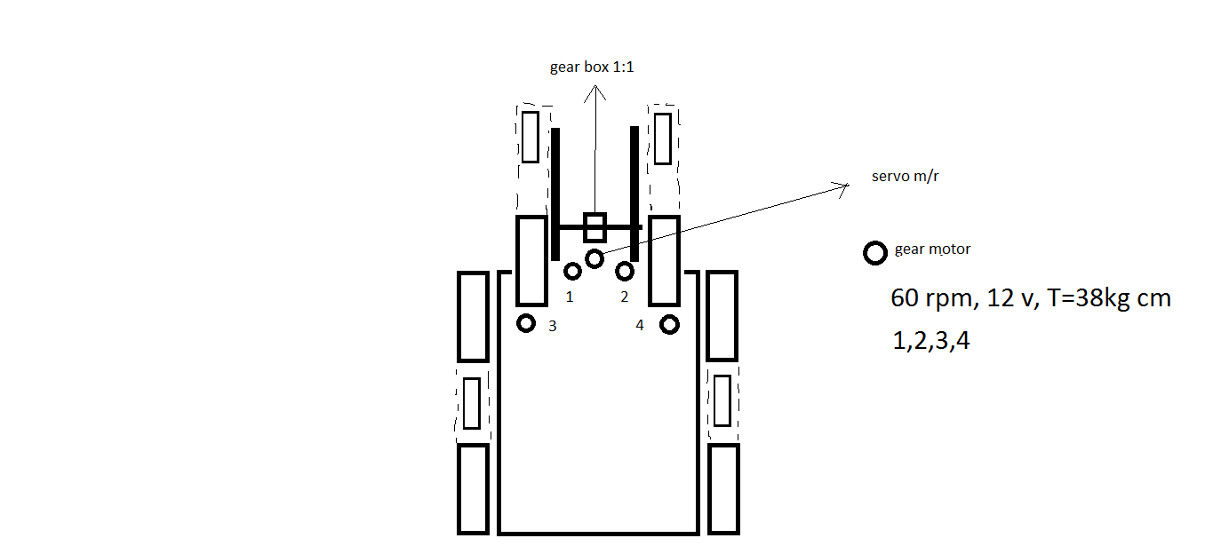

Hi Guys i have read various discussions in this forum, am doing all terrain vehicle as my final year project.. i have read the thread "high torque in dc motor".. The comments helped me a lot in understanding the torque concept in flat, inclined and unstructured surfaces..
am going to use 60 rpm, 12 V gear head motor with torque of 38 kg cm
My question is if am designing a 4 wheeled robot with 4 pully wheels and belt, is it enough to use the above rated motor for the front two wheels?

I did the calculations u said and i hav calculated the torque per motor as 3.53Kg

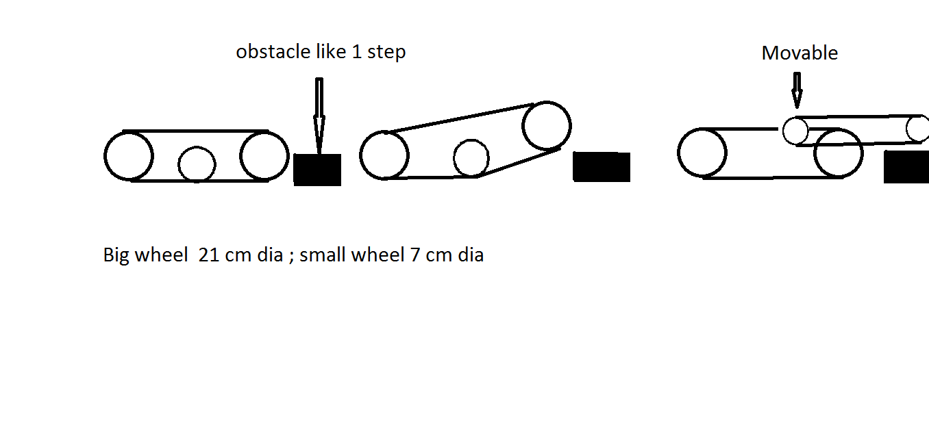

for atv i hav considered tank model
In tank model more number of wheels are attached to the belt, If am using 2 21 cm wheels and 2 6.6 cm wheels on a single side and a belt linking all the above should i use same rating[rpm,torque] motor to drive all its wheels?
Which one would be a better design for the ATV?

The one on the left and middle are about the same except the middle can have superior climbing ability but can't be inverted (unless you make it a parallelogram) The one with the arms is mroe capable of climbing a larger step for the same profile and can flip itself if its upside down but is much more complicated to make. it needs very strong servo motors and a complex mechanism to drive teh arms on the track that can also rotate the arm independently at the same time You'll have a hardd enough time pulling off the design on the left. The moveable climbing track seems in a place different place than is usual though:

But in a simple straight track (like your design on the left), climbing ability is affected by the diameter of the leading pulley/sprocket (just like a wheel). But in a shaped track (like your design in the middle) it is affected by the height of the leading ramp. This leads to an important advantage of tracks- in a shaped track you can make it look like a very large diameter wheel by using a very large ramp but dont need a motor that is geared down by a huge amount because you can use a very small drive sprocket to turn the belt (whereas for wheels you suddenly have a very large radius which is a very long lever arm that needs lots of torque). Moving track arms (like your design on the right) simulates an adjustable shaped track (with a lot more complexity)
All tracks benefit from not getting hung up or stuck as easily as wheels but have high friction turning.
Honestly though...the design on the right with the movign arms is out of the league of anyone who isn't a machinist or cant truly make their own mechanical parts. Even between the left and middle designs, you're probably stuck with what you can pull off. Moving track arms is heavy, bulky, expensive, and complicated and I wouldnt try it. Tracks have enough little parts as it is.
Notice that the second robot I linked to just has arms- there are NO TRACKS on the arms. It just helsp the robot lift itself up a step that is taller than its leading edge sprocket will allow.
" Just center it vertically in the middle of the robot so it is symmetrical upside down and right side up." what does it mean? am unable to imagine..

I dont think it's of same motors as 1 ctrl is for wheel rotation and the other for support arm's angle movement..

To build what is drawn in your design on the right takes the same amount of work and parts (plus a little more because of more motors) than the I-Robot designs that share the same shaft. In both cases you still need a track that can rotate independently of the arm which means you need a hollow shaft, except in your design you have more drive motors and need a longer arm that needs a higher torque servo which also has less usable length because the pivot point positioned farther back than the leadign edge of the robot.
Not sharing the same shaft as the pulley/sprocket for the main track has a lot of disadvantages. You have a longer arm so need a higher torque servo. There is less usable length in the arm to climb because it's pivot point is farther behind the leading edge. You need a separate drive motor for teh arm tracks and the main track on each side (4 drive motors) and unused torque can't be transferred between the arm track and main track because of separate drive motors.
It is a rather curious mechanism isnt it that can rotate the wheel to control the angle of the arm but have the track on teh arm spin without spinning the arm? This is the only way I know to pull this off:
-the same motor and driveshaft is used to spin the main track and the arm tracks (no separate motors for teh main tracks and arm tracks to maintain equal torque and speed and provide full torque to any part of the track that needs it)
-the drive sprocket for the main track and the drive sprocket for the arms are rigidly mounted to the same shaft that they share (duh!)
-the arm's frame itself sits on the drive shaft using a bearing so it can spin around teh shaft independently of the drive sprockets (a little less obvious unless you think about how it must work)
-the idler pulleys are mounted on the arm's frame through bearings so that they can free-spin (obviously)
-the driveshaft is HOLLOW. The outer driveshaft is used for driving the tracks and the arm's frame spins freely around this shaft via a bearing aha! this is where it gets fancy
-the inner shaft is RIGIDLY connected to the arm's frame and connects it to the drive servo and this controls the angle of the arm and that's the last piece of the puzzle
Is that a clear description for you?

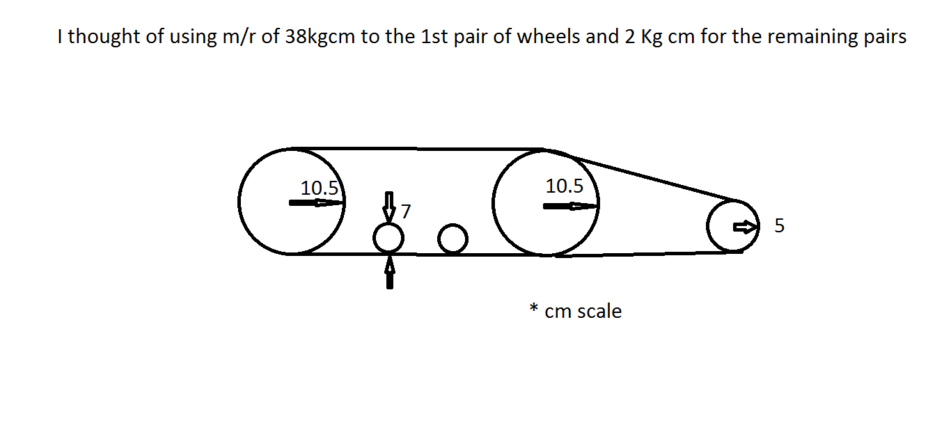

It is 38 kg cm torque, and the m/r rating is same,
I calculated it as 3.5 * 10.5 = 36.75 Kg cm
The above calculation was done for the model which i proposed earlier, in which only one wheel is attached to each motor on the front side, but now as per the design[best ever :)] you proposed am going to drive 2 wheels in a common shaft, does this affect torque by any means?

In case you didnt realize, you can can drive the track from elsewhere. You dont need to drive the outershaft directly with the motor. The track will transfer power wherever it is put into the belt over to the outershaft similar to a belt or chain drive system (just make sure you use a sprocket instead of a idler pulley at the front since an the main track wont be able to transfer power to the arm track using an idler pulley and make sure the sprocket is the same size as the drive sprocket or you will get the arms trying to move at a different speed than the main track). It makes things easier since if you think about it, you can't just connect a motor onto the end of the outershaft to turn it like you normall would because the inner shaft comes out there and connects to the servo. It might make thigns very cramped with the servo and drive motors all being at the front. You have to drive the outershaft from the side whcih means either a small gear on the outershaft or a belt/chain drive system...but you already have on because you have the track. You could place the drive motors and drive sprocket at the back or anywhere else where there is mroe room and mount it to a regular solid shaft.
The required torque is only affected by the sprocekts being driven by the motor and the sprockets that are driving other belts (like the one that drives the arm track and is beign driven by the main track). The size of the other sprockets and idler pulleys don't matter since they just go along for the ride. Hollow shaft doesnt change anything.
You mention 3.8kg for soem wheels and 2kg for other wheels. Thsi doesnt make sense because of what I just said. A motor driving a shaft spins the wheel using torque because its spinning the wheel at the center. A driven track turning other sprockets uses FORCE because it pushes the sprocket from the edge, not rotating its center. It's like pulling on a rope and dragging along thigns tied along the rope. They all have the same force applied to them.
If you use the belt to drive a sprocket and have a shaft at the center of the sprocket to turn something else, then that's torque. Just like pulling a rope to turn a pulley attached to a shaft.
What havign more track does affect is the pressure on the ground. That's why tracked vehicles can move over softer ground than wheels. The total friction is the same, except it's spread thinly over a larger area rather than being concentrated in a small spot. Friction is independent of area in case you didnt know. It only depends on the normal force.
Also, torque is actually m*r, not m/r. Kg-cm, not kg/cm.

Thee width of the belt makes no difference in the friction. It reduces the pressure on the ground so it won't sink into soft soil or snow or mud as easily, but total friction is the same (which is often pretty significant). It's pretty hard to get your car stuck in snow if it doesn't sink in. So you wont have extra traction but you wont bog down and get stick like that.
When you increase the contact patch you increase the total area and the force is spread more thinly over that area. Decreasing the contact patch decreases teh total area but the force is more concentrated in that smaller area (ie. more pressure).
Hmm ok i now understand the theory part of it, when width inc. force is distributed

Yeah, you want to use sprockets to drive the belt because of slippage. It also makes it so you dont need to tension the belt as much, otherwise the belt will have to be very tight. A wide belt with more contact area might help not slip if the belt is tight. But it doesnt help if the belt is loose and part of the belt will always be loose.
Look at a bicycle chain, notice that one side is loose and the other side is tight. If you reverse direction then the side that is loose and under tension switches. The sprocket will either pull the belt into tension or push the belt so it is loose depending on the direction it is rotating and whether the drive sprocket is driving the belt from the middle, front or at the back. This is not good if you are using pulleys since when the sprocket pushes teh belt it gets a bit more loose and you lose tension and the belt might even pop off.
For example a track going forward with the drive sprocket at the front will pull the track on top so it is tight and push the belt on the bottom so it is loose. If you go backwards, then the top gets pushed and becomes loose. This is bad because it means that the loose belt on the bottom well flex over the ground and you lose traction and the belt might even pop off the sprocket. This is why you use idler pulleys to press the bottom of the belt onto the ground and to stop a loose belt from popping off.
If you have the drive sprocket at teh back then the bottom is pulled tight and the top is pushed loose when going forward. And the bottom is pushed loose while teh top is puled tight when going backwards.
If the drive sprocket is driving the just the top or the bottom of the belt from the middle, then one side (left or right) will be pushed loose and the other side will be pulled tight. If you have a sprocket in the middle of the belt that is driving the belt from the top and bottom at same time, then you have top-left, top-right, bottom-left, and bottom-right.
Some designs have the motor/drive sprocket at the front on one side and at teh back on the otehr side because of limited space for the motor. In this case the belt touchign the ground is always loose on one side and tight on the other.
You can use pulleys just to make sure the middle of the belt is pressed to the ground so it doesnt flex over bumps and if the pulley also has a lip then it also helps so the belt doesn't pop off which can be very important especially for long loose tracks. Of course if you are using toothed/timing belts, you can just use idler sprockets too and that stops it from flexing over the ground and popping off. Look at tank tracks. The two large sprockets at the front- one is the drive sprocket. And then there area ton of little pulleys in the middle. These are there to help keep the track from popping off and to press the track against the ground when it is loose. It's one reason why good tracks are very heavy and have lots of little parts.
That's why timing/toothed belts sprockets are preferred over toothless belts for tracks.
