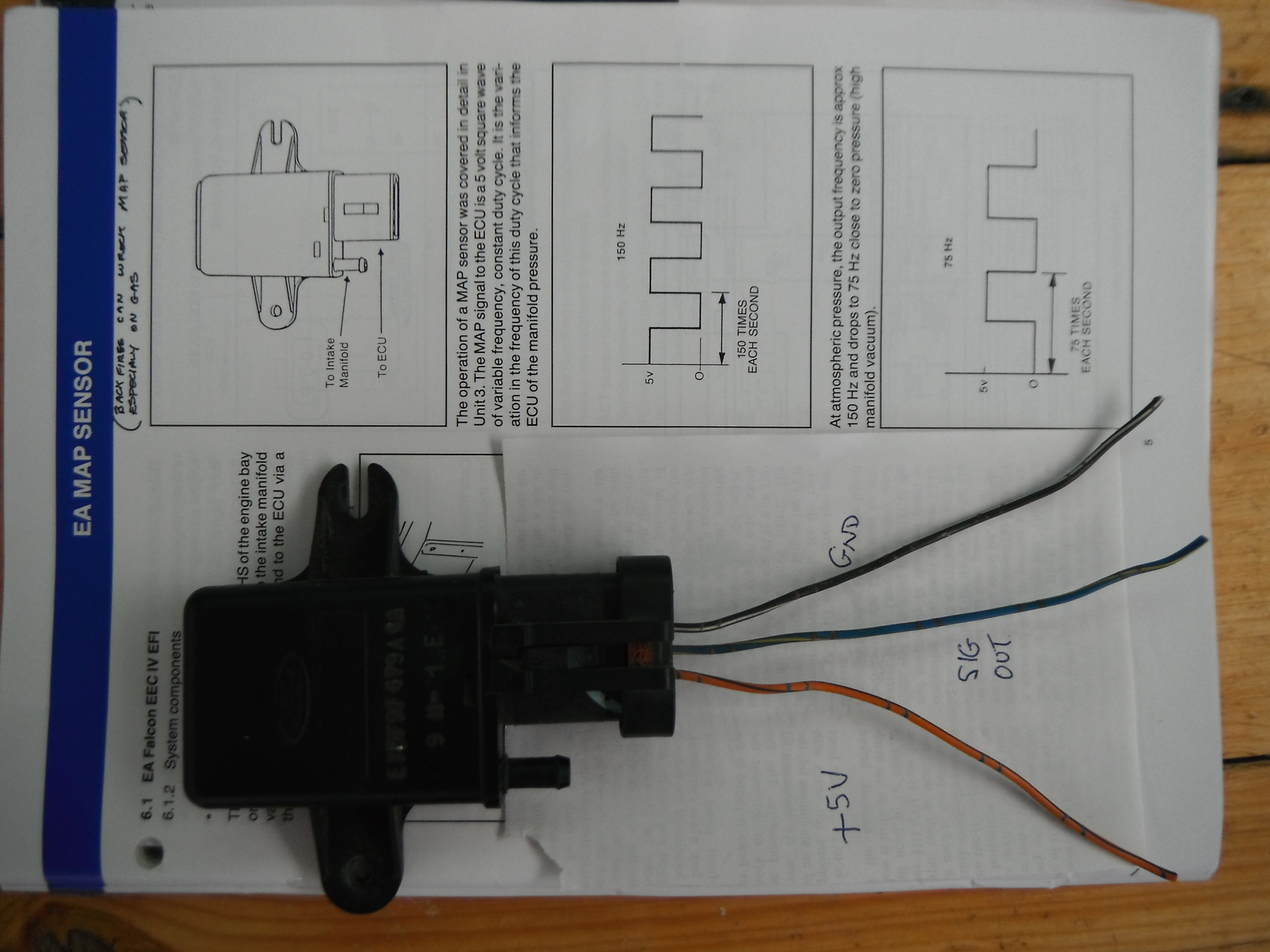

If you can get into the ECU, maybe adapt this Variable freq MAP sensor to feed the ECU. This is a Ford part but i think they are made by Bosch. The freq is 75Hz to 150Hz.
Thanks for making a photo!

I was optimistic something could be done external to the IC, maybe using your MAF sensor or something similar, and additional circuitry to generate the variable inductance without the need to go inside the IC.
