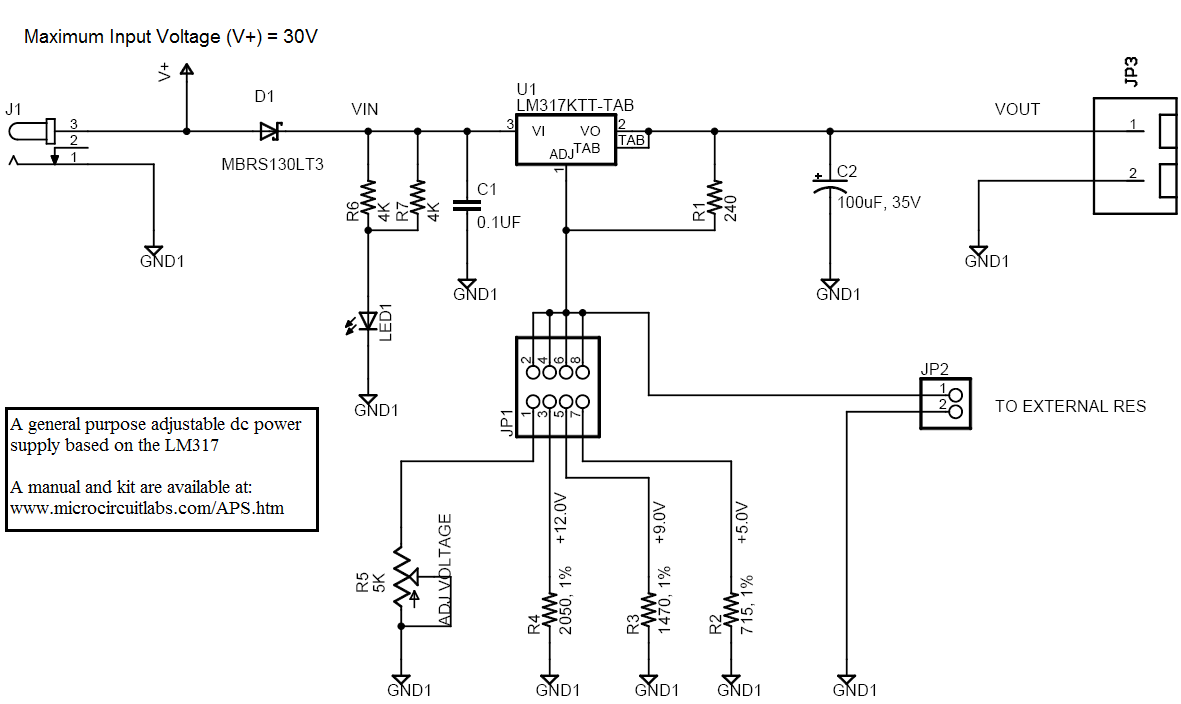

Here is a schematic for a general purpose dc power supply that is adjustable from 1.2V to 27V, up to 0.5A. The circuit is based on the LM317.
Changing the LM317 to a LM317HV and a higher voltage output capacitor (C2) would extend the voltage range up to 60V. This circuit is good to 1.5A with the proper heatsink. For higher current, a different design will be needed.
Also, current and voltage readouts could be added using pre-assembled digital panel meters.

jfedison,
Because R1 is 240R the minimum load current will be 5mA, for a minimum load current of 0mA use 120 and halve the value of R2 to R5, nearest 1% values are 357, 7320, 1020 and 2.5k for the pot.
Using Appropriate Power Transistors/Heatsinks, this supply can supply almost any voltage at any Current.
Although This MC1466 IC is Discontinued, This Circuit Duplicates it very well.
