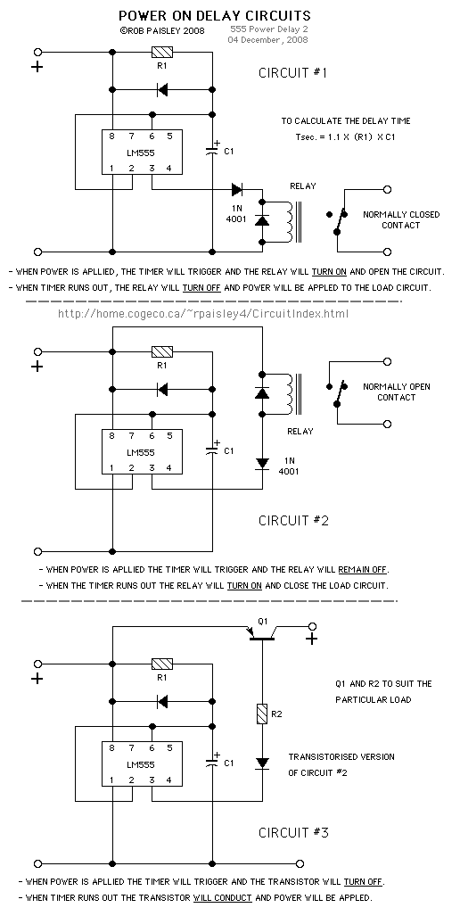

leds and small project but i recently created a pneumatic air cannon operated by a sprinkler valve. I have already created a simple 18v circuit( two 9v batteries) and a momentary switch to open the valve; however, I was looking for some help with creating something a little more fancy. Thinking about using a resistor and capacitor( i believe) to set a time interval of when the button can be pushed to fire the cannon. I wanted a master power switch with indicator led. Then after 7 seconds or so power would be ready to pass through the momentary switch ( another indicator led) and to the valve. Simply to prevent the cannon which is CO2 fed to fire before the tank has reached a present psi or on accident injuring someone. then after each fire the current to the momentary would be delayed for 7 seconds( approx).

There are dozens of ways to create a delay, but for simple and cheap timing with a fair accuracy in analog terms a LM555 Timer IC is still hard to beat!
Here is the basic specs sheet for the LM555. It shows several timing setups.

Ok after a little research on the 555 ci timer iIcame up with a couple things,
one, I will most likely be wiring the timer in a monostable, or one shot circuit.
two, it will need to run on nor more then 15v so a voltage regulator will be needed
last, I will really be needed help while figuring this out
I found a schematic used to delay voltage to a relay to trigger another circuit.(attached, the middle schematic about voltage remaining off for set delay)
I quickly made this circuit to figure it out it worked flawlessly, my time of 7 seconds was accurate and the 18 volts I had running through it went from zero to 18 after exactly 7 seconds. upon attempting to add Leds where i needed them ( master power and ready to fire indicator) the circuit began to malfunction. I also found that trying to substitute the relay control with what i needed would not work.
What i am asking is how would i modify this to achieve my above statement for an air cannon controller.
