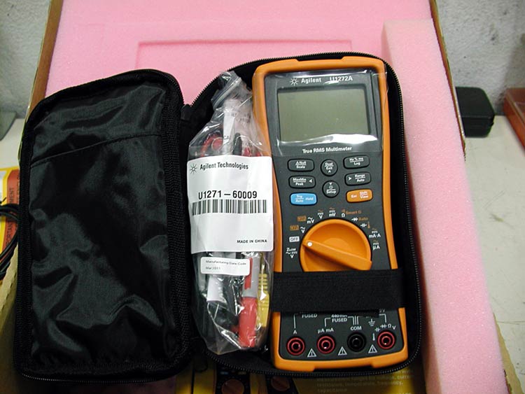

By getting the demonstration unit, the first impression was positive.
The unit is large, feels good in your hand, large LCD display easily viewable from a distance.
No problems by viewing it on bright daylight or in low light conditions.
The back light is very effective, and transforms the multimeter in to an object of desire. (I love that Orange tint)

The supplied test leads are well made.
The cables haves this new modular design that you can hook on them test probes of any diameter, or large Alligator Clips, or even cable extensions.
On the 2mm Test probes you can add one range of smaller accessories for example Alligator Clips / SMT Grabbers / fine tips, they are Anti-slip with nice finger guards, in the bag there is two sets of probes, fully isolated for electrical work and standard 2mm for automotive – electronics etc.
Among the standard accessories there is also and one K type thermocouple.

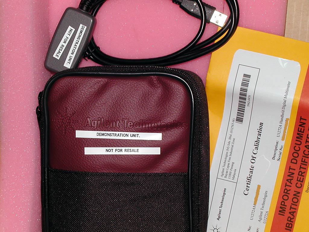

Extra accessories: (That it I would recommend to get.)
The soft carrying case part code U1174A.
Fine Tip Test Probes part code U1164A. (Automotive work or electronics)
And the IR-USB cable for PC connectivity, part code U1173A
Agilent offers one wide variety of temperature probes, among them the surface temperature probe U1182A that it looks to target industrial applications, I am positive in the idea about having the chance to test it too, in to a later time.

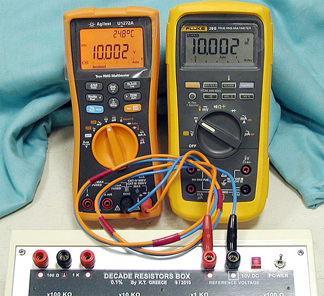

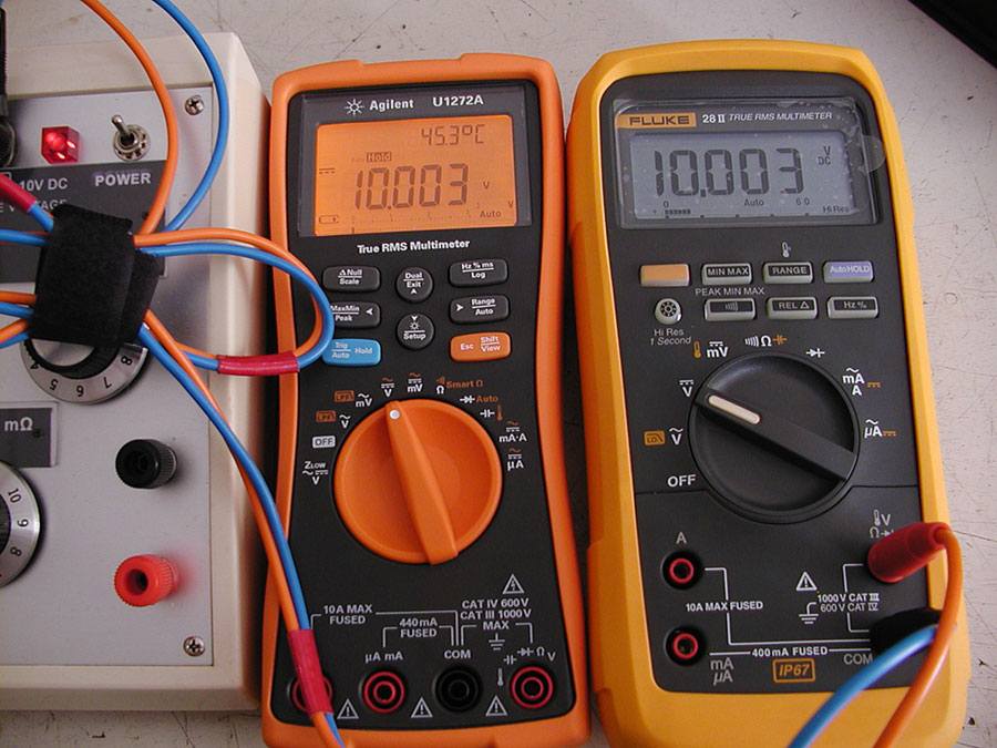

Resistance / capacitance / Diodes / DC-volts /
Agilent is a very respectable brand name about accuracy and measurements world wide, and I feel too small about challenging them in this area.
But I am crazy enough so to try it, even if they use the latest Fluke calibrators, or even offer a calibration report with its U1272A right from the factory.
I did my own accuracy tests, even by comparing U1272A side by side with the Fluke 28II (Brother of the 87V), or even by using some basic Precision Reference sources that I own.
Portable voltage and current calibrator: 1030 MicroCal (Time Electronics U.K.)
And my Home made resistors decade box:
Resistors DALE USA 0.1% , 10 micro Ohm to 999K ohms.
Silver plated switches by JANCO California (airplane cockpit parts)
Plus one DC Precision Reference LT1021 10V
by Linear Technology Corporation in California.
After the end of my testing cycle, I can only say that I have lost my chance to find something wrong with it, and I ended up with a large smile on my face, even if had lost in this specific challenge.
The U1272A and the Fluke 28II and my testing gear, looks as one properly tuned orchestra.
The U1272A is a bit faster, and in the ohms range it is a pleasure to watch it.
The extra speed has also and one small downside, when you measure mV and the source is not that stable, the digits on the LCD will update in a high rate, which makes it a bit troublesome to watch the readings.
Thankfully Agilent added to it one function called as (Smooth), it can be automatically or manually activated, and adjusted by the user.
By adjusting the samples to about thirty, I did solve the problem in the specific measurement that I had a problem with.

I love my tools and I do babysit them allot, and so I am always careful with them about to not exposing them to extreme temperatures with out a good reason.

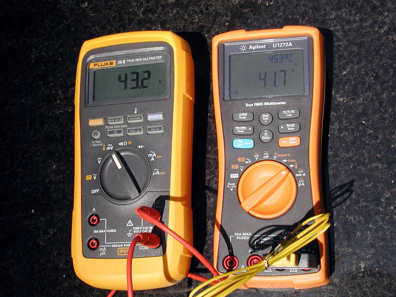

But because of this review, I took advantage of the hottest summer days in the hart of July in Greece, so to perform the Extreme temperature test.
The plan was to find out what happens with temperatures above the 40C.
And because I love comparisons, I set the U1272A and the Fluke 28II under the direct sunlight for 45 minutes.
As soon the internal K probe of the Agilent stabilized in the temperature of 45.5C,
I took both units instantly back in my work shop, and I tested their accuracy at 10V DC, and the Ohms range.
Both units were spot on.
Other observations from the extreme heat test:
No problem with the LCD at such high temperatures, like fading digits, or no digits at all.
The orange is a bit darker color than the yellow Fluke holster, and so the U1272A it did run a bit hotter internally by +3C.
The paradox was that at 45.5C = 113.93F the Fluke holster started feel as very sticky in my palm, I got motivated to check and the U1272A, and I found that the rubber body of it was very hot as expected but no sticky.
