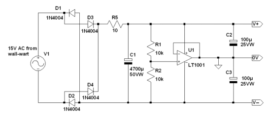

Here's a schematic for a simple (non-regulated) +9V/-9V supply powered from a 15V AC wall-wart rated at ~100mA or more.

If it specifies +/-15v you may not get proper performance running from +/-9v, the analog synth may not reproduce the envelope or filter waveforms properly.
Since you can get 15v wall warts fro a few dollars each I think Canadaelk had the right idea; just buy two 15v wall warts. :)
Thanks. Yes, I had thought of that problem with performance but my knowledge is lacking and it's hard to find out about certain things when you've never heard of them or don't know what the proper name is ( I am trying to start at the beginning with basic electronic books too now!) - someone gave me notes on changing certain parts of the circuit and he is running 2 x 9v batteries to overcome power supply issue but I would go through too many batteries that way so it wasn't ideal. The best solution I have found so far is the 'music-from-outer-space' AC wall wart to bipolar board.. This is mainly because I'm not comfortable wiring up the normal +/- linear supply that works off mains power as it could be a bit dangerous for me to be experimenting with 240v so this would allow me to use an AC wall-wart and wire up a board kit to output +/- 12v so I'm looking into if that would power a +/- 15v board.. May just try that kit anyway as would come in useful in the future.. The kit costs about $32 I think.. just trying to find out now if there is anything similar in the UK or ideally one that can output the required +/- 15v which would be perfect if that is possible from an AC wall wart.. I'm getting there slowly!.. Thanks again.
