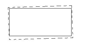

The touch sometimes comes like this
So I use the middle and then go to all four corners making four different maps.
Oh wow, that's cool. Do you use the uC's builtin ADC to do this? Well, I'm stuck with this controller for now, heh. Also, thank you for clearing up the A2-A0, looking back at the data sheet it makes a bit more sense.
Ouch, I can see from the above picture how mechanically the touch screen can sometimes not be properly be placed over the LCD screen, thanks for clearing that up as well. My last question mainly deals with the calibration. Once you get those coordinates what exactly do you do with them? For example, say the center is supposed to be (320/2,240/2) or (160,120) and I read (200,150) which is off by 40 for X and 30 for Y. Do I just add or subtract (in this case) the amount it is off by, and for areas close to the center use that offset (and for the corners use their respective offsets)? Or do I average the offsets of the center and corners and use that as the "overall" offset?
Even when it IS placed properly, this can happen..
It can sometimes be a little crooked as well... But to make the most of it I calibrate 4 parts instead of one... This makes it a little more linear..
